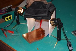

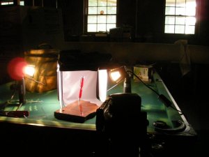

I have a tiny "studio" that I got from RadioShack for $20 (Sakar PS101 - shop around, it can still be had for $20, not the $60++ from Amazon!). The package comes with a tiny box (about 10-12" square side panels) and a couple small lights. Because they're so small, I've developed a technique using lots of shadow play, versus omnipresent light. Not saying one's better than the other, but you use what you got!
The left pic shows the general layout (on the long abandoned kids' pool table) - studio/tent, lights and board I use to support the pens.

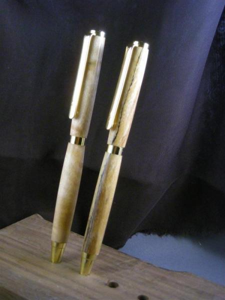

Bottom line - I went from this on the old Coolpix camera:

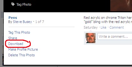

to this. Also, I upload them first onto facebook, then link the image to here so they can be bigger and sharper. How's that working for me?
