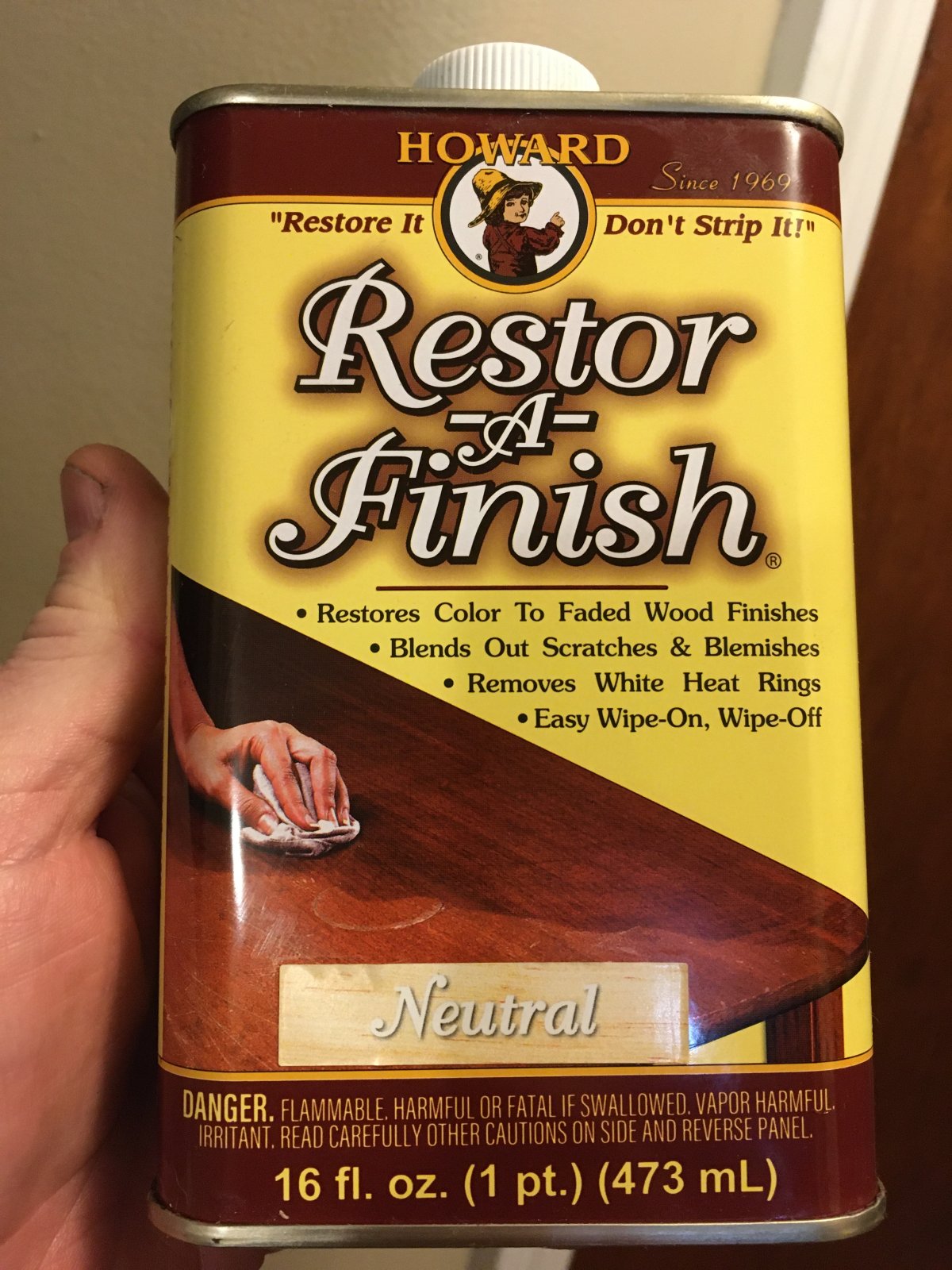

I have this 60s credenza kind of piece that had a few scratches on it when I got it. It was good enough to use as is, but after it had a bit of simple water damage to the finish while in storage I decided to help it out a little. I just found this can of restorer I used on it. Simply cleaned it off and wiped it on, and it turned out great honestly. All the scratches disappeared, as well as the area affected by the water.
What is it?...mayonaise that takes out water stains? Now I'm thinking I might better just treat the water stain (if possible) and lay on a coat of this stuff and see how it looks. Any thoughts?... Wonder if it'll unnaturally darken that worn corner?
Wife inherited one of those antique 'secretaries' - a home furniture item that was intended to serve as a desk back the days when your home office contained only a checkbook and a bottle of fountain pen ink. She keeps it in the family room. It was looking a bit sad, but I didn't want to do a complete refinish.
Instead, I used Howard's Restore-a-Finish to clean off the surface, and then applied wax polish (Howard's Feed-n-Wax). In both cases I used a 4/0 steel wool pad as an applicator. It looks better - and the important thing is that wife was happy with the result.
Yep, happy wife happy life. Good to hear you've seen success with this too. I believe I just used a cotton rag to apply it to my previous piece. So it's ok to use 4/0 steel wool to apply it? Is there any advantage to using the wool?
