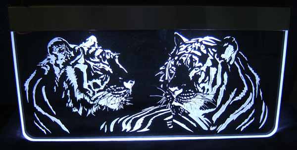

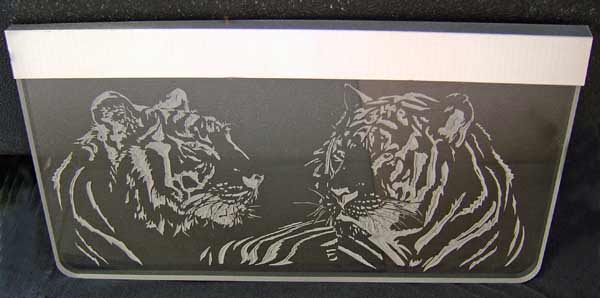

Been working on a design to make this work.
I finally finished the design and ran one to test the concept.
There is only one minor adjustment to make to the shroud.
The engraved designs are limitless and the light color can be anything, if the RGB's are used. This one utilizes the IP67 super white.
The dimensions are 6"x12".
I'll see if anyone can figure out the end product. It may, or may not be legal in your state.
Thanks for looking.

So is the lighted effect accomplished just using edge lighting or is it backlit?
It is edge lit of sorts. The lighting was one of the concepts I was trying to work out.
It has the mounting holes cut in it (although the shroud doesn't, yet), and I was concerned that would keep the light from reaching the engraving toward the edges. It works better than expected.

Lighted pen box top. LEDs behind your work in a shallow top frame. Wiring through flexible tubing in the back. Can I expect one in the mail? :)
Lighting behind the image won't work. It would just wash it out and have hot spots. There's no need for flex tubing, just create a channel. A pen box is fairly small to fit everything into. The acrylic has to be thicker than the width of the light, it would require a battery box and switch, and the image would be incredibly small.
However, a pen display unit would open up options, and could work well at shows, with a logo and contact information on the sides. Lit shelves set at an angle, so the front edge and the resting holes are lit up.
