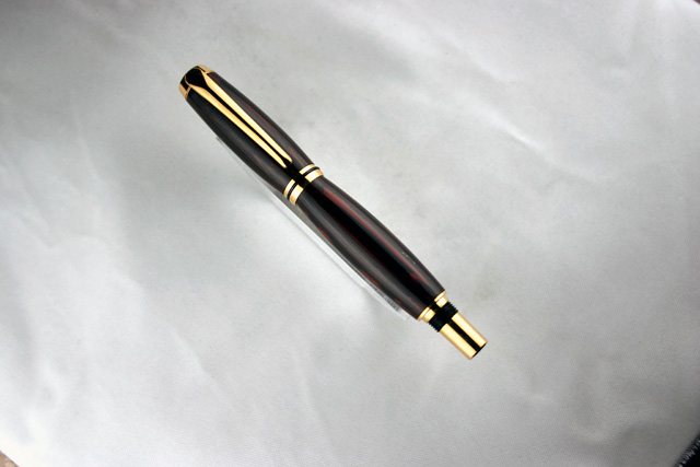

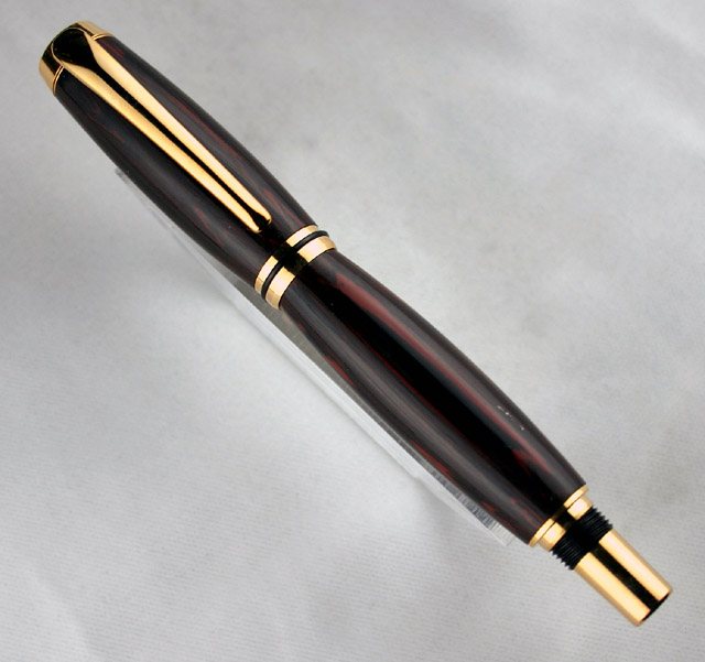

A common theme in pen photography is that the picture is not big enough to see the detail. As you will witness by my own pictures below, I am not a great photographer. That being said, there is a trick to photo composition which will help us see you pen and should result in a more accurate critiues. If your camera and software let you make these changes, it should help us help you.
Note: All pictures sized at 640 pixels wide and the same camera settings were used. Also, each pair of pictures is the same picture with only the cropping being different.
Traditional pose: Either a straight vertical or straight horizontal picture.
Same picture cropped tighter.
Image Insert:
Same pen photographed at a 45-degree angle.
Image Insert:
45-degree angle with tighter cropping.
Image Insert:
As you can see, my photography didn't get any better, but you sure can see the detail better.

don't mean to swell your head to much. but the tight cropped photos I woudl use as example of about as good as they get.
very good lighting. they show the highlights but they don't overpower the rest of the pen,(this is very hard to do)
the light surrounds the pen which is also very hard to get good at. the background is fantastic, and you did it with a dark subject. overall I think you are showing a supreme example of a pen photo. but that's just my taste. now just air brush out that one tiny little flaw in the barrel and you can print and mount this one on your wall.
it really is good to see photos of this quality starting to get taken by members of this group. thanks
