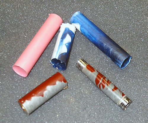

I recently cast my first blanks using Simlar and found it quite easy to work with. Other than the odor I like it. Turned like butter. Colored well with automotive paint and mixed in some dry pearl in the pink one. Got mine from Mr Fiberglass. Got a lead for a supplier of another resin up in Chicago. Going to get a gallon and give it a try. If I like it it is available in drums!!![:D]

I got my first quart from Michaels. It was Cast 'N Craft Clear casting resin. I did this in case casting my own wasn't for me. After my very first cast I was hooked and have since bought only from Mr. Fiberglass, as mentioned by Don. I have also experimented with using a variety of coloring methods, and numerous other inclusions. Some worked, some didn't, but half the fun is in the experimentation. For example, cheap acrylic paints from WallyWorld have worked well for me in adding color.
Just a note of caution. For my first few castings I noticed that I got a headache. I made sure my shop was well ventilated, but that didn't seem to help. I then bought a respirator from HF and made sure to use the canister filters for chemical fumes (I can't remember the specifics). The filters for particulate matter won't work, and neither will a dust mask. I no longer get a headache when mixing, and I make sure to move my castings out of the shop while curing. If you have a covered patio and appropriate ambient temperatures you can let them cure there.
