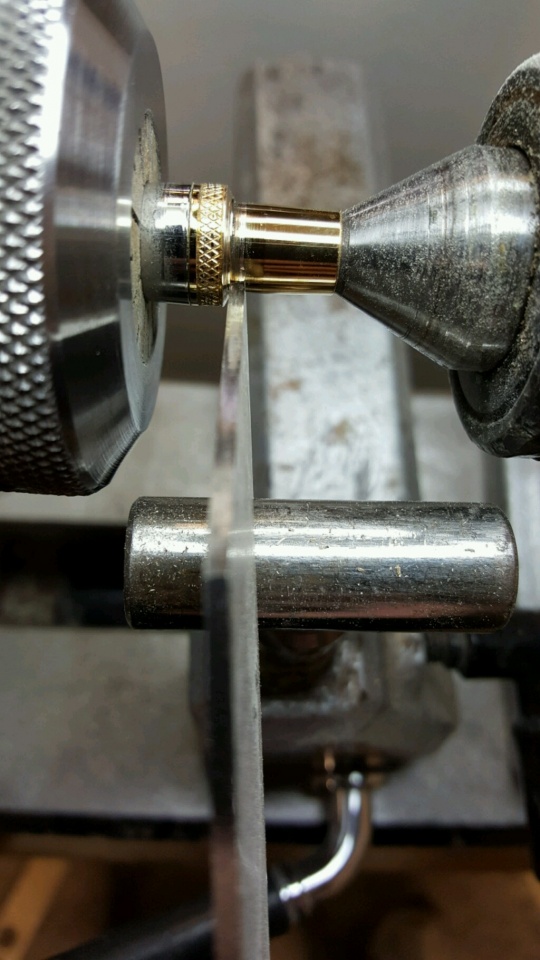

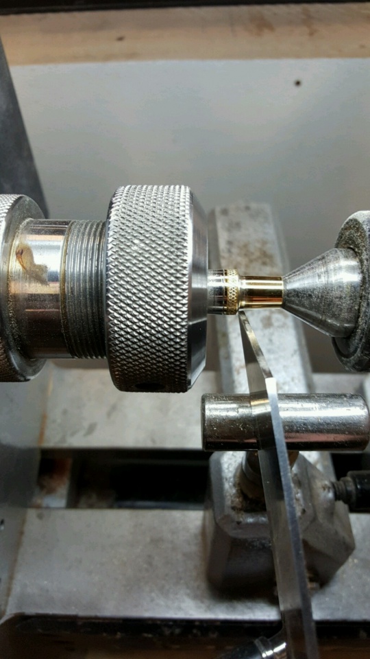

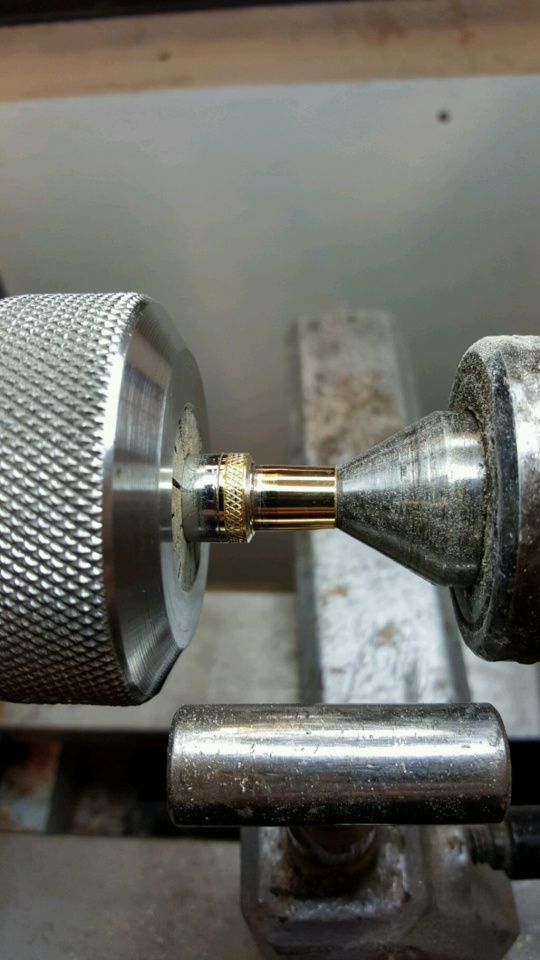

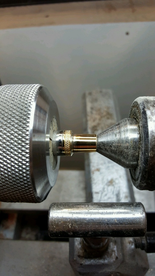

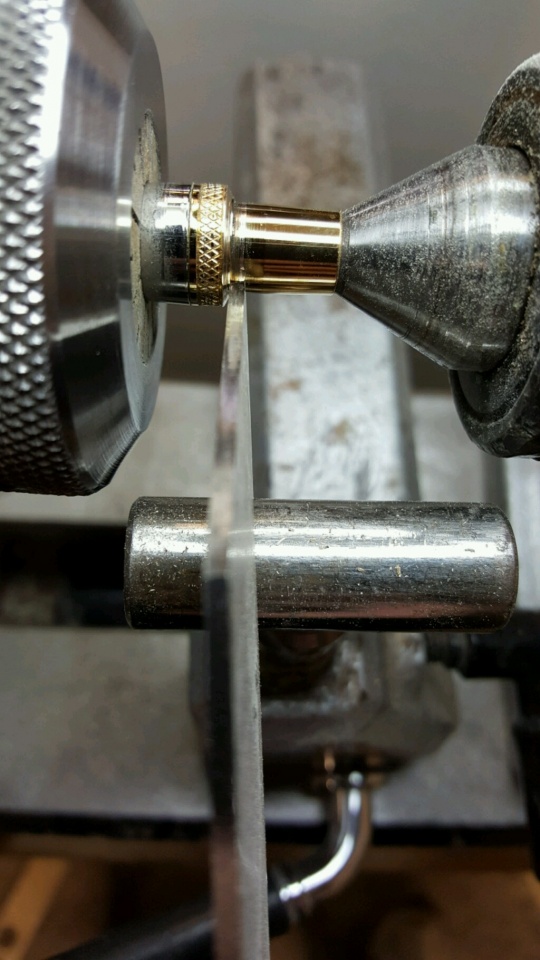

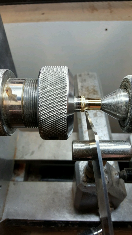

I put an old Sierra grip piece into a collet chuck and turned the metal trim ring down with a parting tool. About an eighth of an inch was all I needed, so I turned the metal down to flush with the tube that screws onto the tranny.
That gave me clearance to both grab the tranny and to wiggle it a bit to work it loose, without putting pressure on the barrel material so I could save the pen.
