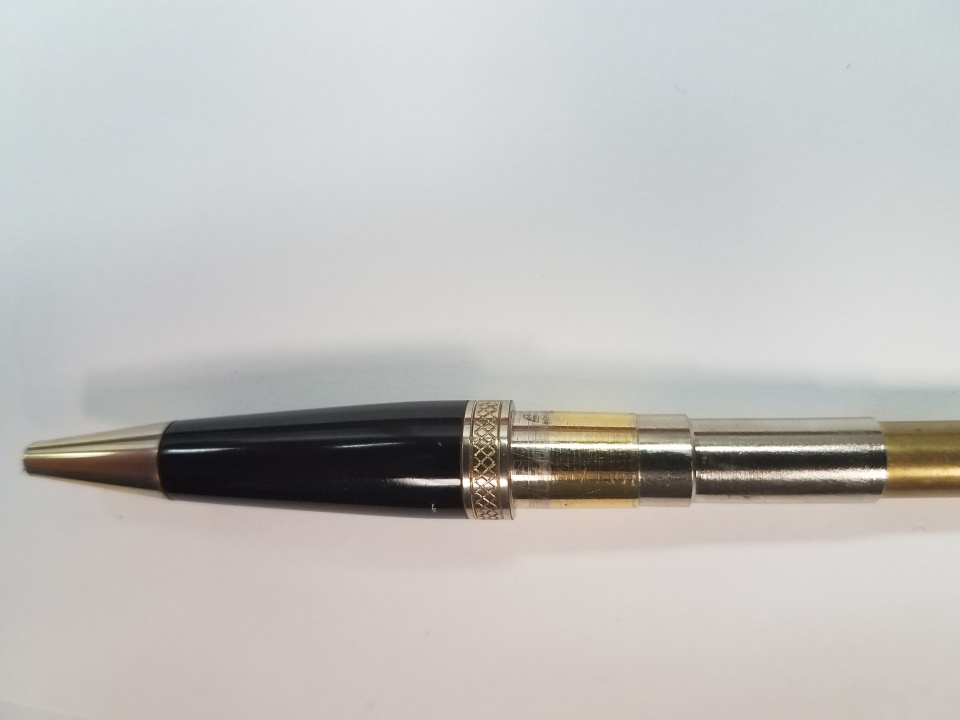

The kits are Berea. There is some visible wear - see picture.
I don't think it's a major issue. My guess is that the user may be somewhat aggressive and twists past the "open" position and then when they twist to close, they twist too far and the transmission starts to unscrew.

From the picture, it appears to be an issue with the blank and tube rather then the kit.
If you remove the glue and burrs from inside the brass tube you should not have the issues.
Bill,
The wear marks seem to be suggestive of the condition that curlyjoe mentioned.
But I would think that condition would manifest itself immediately after assembly
(not "after awhile" as you stated in the OP).
