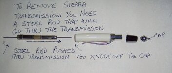

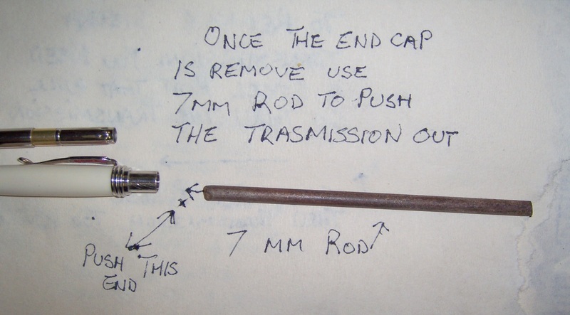

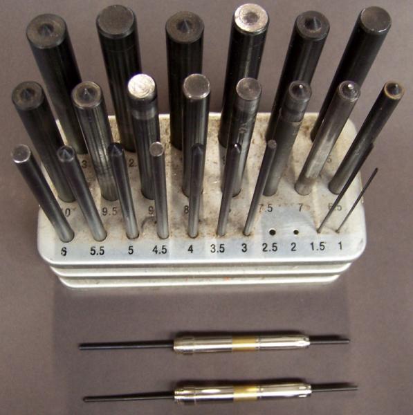

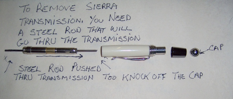

To remove SIERRA Transmission get your self a set of center punches.
There are 2 different transmissions in sierra kits, one kit will take a 2.5mm center punch and it will fit easy,The other size transmission you will need a 2.0mm center punch and it is a tight fit to push the punch thru the Transmission. When you get the punch thru transmission knock the end of the punch onto a block of steel and the cap will pop off then i use a 7mm punch to push the transmission out.

Thank You! I have that set of punches, I guess I just never noticed that the transmission was hollow <silly me>
