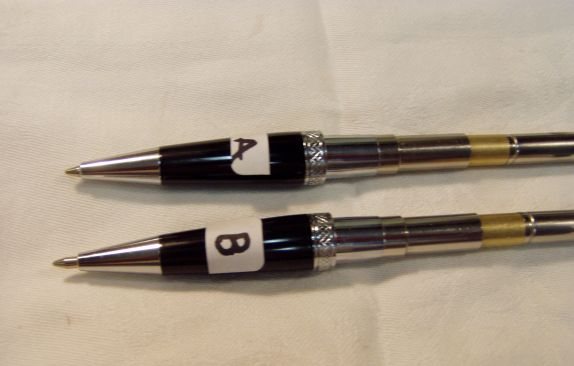

It's the first time I have a problem like this with the Sierra pen kit, I read that some of you have problem with mechanism but does any one have this happen to them.
So I decide to take some calibration
First inside of the Sierra nib I notice a ring who will stop the ink refill to go further out, ( please some one tell me if I'm right )
Now I see that the inside ring as been push to far down ( I mean toward the nib )nib B to compared to nib A
Does any one have any ideas to pull the ring out further to reach the measuring of the nib A? or do I have to use this kit as spare part:(

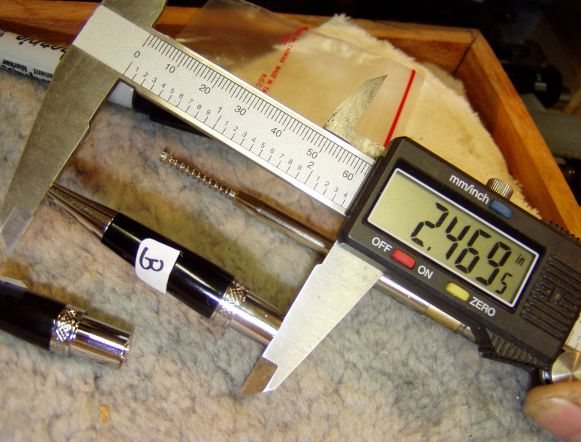

Haven`t seen that problem Serge . It might be possible to remove the nib tip from the rest of the tip assembly with a 1/4 in transfer punch , and then use a 5/16 to tap the ring back to it`s proper position . Wayne
Serge: I think you are barking up the wrong tree.
I'm not sure exactly what the "ring" is that you are seeing; but I don't think it has anything to do with your problem. The distance that the cartridge tip extends from the pen tip is controlled by the transmission and not by anything in the tip. You can prove this by removing the spring from the refill and putting it in the Sierra "nib." I think you will find that just like my Sierra, the tip of the refill extends from the tip of the pen by about 15mm....a much greater distance than shown in either of your pictures. Even with the spring on the refill, the refill tip extends about 10mm.
The information you have provided leads me to believe that the problem lies either with the refill or the transmission. First thing to do is make sure that both refills are the same length. It would be a rare occurrence if they were not the same length; but stranger things have happened.
My guess is that one of the transmissions is defective. Try switching the transmissions from one nib to the other and see if the problem is transferred from one nib to the other.
The other reason I don't think it is your "ring" is the following. The difference in the two measurements that you showed is 0.062". I can't be sure, but from your picture, it looks like the difference between the extension of the two refill tips is quite a bit more than that.
Another thing you might do is measure the total length of both nibs and be sure they are the same length. In the picture they look to be pretty close; but I can't be sure. The measured length of mine is 2.530".
Let me know what you find out. If this doesn't help, we'll will try something else until we get it figured out.
Added: While you are at it, measure the length of the transmissions. Mine measures about 2.365".

Ligget and Martin thanks will try to solve the matter.

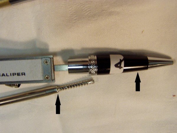

Randy I do have 14 sierra pen kits and I try all parts switching refill and mechanism around only this nib ( B ) is faulty, now Randy if you can take 1 of your sierra pen kit and with the depth gauge of your caliper read the measument then tell me what is the reading, I think that if the refill tip goes out of the pen nib 10m/m to 15 m/m you're talking about dart [:D] never see a refill goin out so much, no offence here, my reading are correct. Can someone take a photo of is Sierra with the nib out ready for writing and post here would like to see if I'm right or Randy is right, Thanks
Serge: I think you may have missed my point. In my assembled pen, the tip configuration looks exactly like your nib "A". Just the cone shaped tip of the refill extends from the pen.
When I talked about the refill tip sticking out 10mm+, that was by pushing on the end of the refill with a finger without the the transmission being in place. To me the fact that the refill will extend so far shows that the transmission controls the extension of the refill and not something inside the nib.
As I recall, there is a little step or shoulder inside the nib; but I think it is the end of the tip that has been pressed into the nib and not some sort of separate movable "ring".
I'll run out to the shop in a few minutes and measure the distance to that shoulder to see how it compares with the measurements you posted.
Since you are still of the opinion that the problem is with nib "B", would you measure the length of your nib and see how it compares with the length that I mentioned for mine.
Thanks

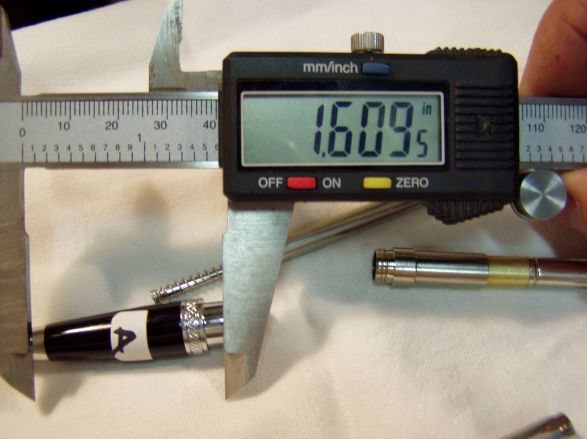

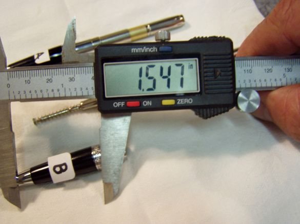

I selected three kits at random from my Sierra inventory and measured each. They measured:
1.557"
1.565"
1.560"
Not that I think it is a consideration; but each kit was a different plating.

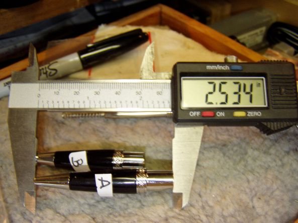

Serge,
I measured the length of one of my Sierra nibs and it was between 2 1/2 and 2 9/16 inches long. This is in agreement with Randy's measurement. Check the length of nib "B". I believe you will find that it is shorter. You can compensate for this difference by pushing the transmission back out of the housing by an amount equal to the difference. This will result in a "matched" nib/transmission combination providing for the correct amount of tip exposure. Of course these parts WILL NOT be interchangeable with any of your other kits. If you are not sure how to push the transmission back out, PM me and I will try to give you some detailed instructions that should work.

Originally posted by pssherman
<br />...If you are not sure how to push the transmission back out, PM me and I will try to give you some detailed instructions that should work.
Paul: Why don't you just post them here? I suspect there are others who would like to have that information, myself included.

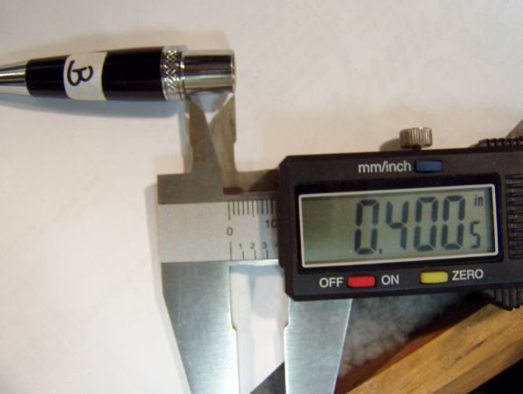

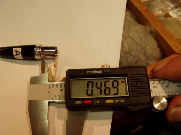

Randy spot on, did again another reading for the out side nib look like the measurment are different
<br />
<br />
<br />
<br />
Randy you got your 0.062" + will have to figure out how I can save this faulty nib,, Thanks for your help Randy and everyone

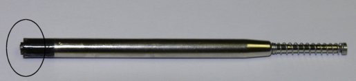

No problem.
I have never encountered this problem before, so, I have not tried any of these suggestions yet. But, being a mechanical engineering professor, one of my 'best' talents is problem-solving. Here are the possible solutions to this problem if you can't resolve this with the supplier/manufacturer.
1) Trim the length of the refill at the area circled. This will need to be repeated every time the refill is changed. Therefor, it is not a good idea if you are selling or giving away this pen. You don't want to have the customer doing this every time they change the refill.

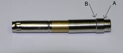

4) Push the transmission back out of the assembly to compensate for the shortened nib. To do this, make a hollow tube that fits snug against the assembly and rests against the shoulder at point B and extends beyond the transmission. Insert a transfer punch inside the threaded tube and use a press to push the transmission back out a little ways. If you push it too far, it can always be pushed back in the same way we install transmissions in other pens. As mentioned before, I have not tried this, but the brass portion of the transmission appears to be press-fit into the stepped, threaded tube and should be able to be corrected in this manner. But I am not able to confirm this at this time.

Randy,
If you look at the transmission, there is a portion that is brass that is press-fit into the stepped tube. The rotating portion does have a roll crimp on it which holds the lower and upper portions together. If you use a transfer punch that just fits inside the stepped tube you will be pushing on the brass portion not the rotating portion. This will prevent damage to the rolled crimp.
The layout of the transmission is the same as for the slimline transmission but the brass portion is much longer. Pushing the transmission out would be the same as disassembling a slimline except that you support the shoulder of the stepped tube instead of the blank.
Paul in AR

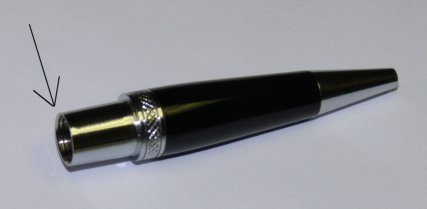

Paul; That is not the crimp I am talking about. Take a very careful look at the threaded coupling about 0.08" from the end where the brass of the transmission is pressed into it. You may need to rotate it a bit to get the light just right. Good eyes and a magnifying glass are a help, too. There is a very faint impressed ring in the coupling that I take to be a crimp. I suppose it could just be a tooling mark; but I see it on all of my kits and think it is there by design. It is just a little too much of a coincidence that the "crimp" falls exactly in the middle of the brass section of the transmission that is inside of the coupling!!
Randy,
The one that I have been looking at (shown in the photo of a previous post) does not seem to have a crimp where you mention. I received this pen in a pen swap about a year ago and wonder if there could be slight differences between manufacturers and/or year of production.
Anyway, a crimp in the location you describe would serve to increase the clamping force of the press fit. Unless you push the brass portion past this crimp, there should be little or no effect on clamping force. If there is any doubt as to the strength of the press fit after moving the transmission one could: a) apply a drop of CA to reinforce the press fit or b) use a small tubing cutter with a little pressure on the cutting wheel to put an indentation (crimp) near the point where the brass enters the stepped tube.
By small tubing cutter, I mean the kind that is intended to be used for small tubes, not copper piping and use only enough pressure to indent the surface, not cut though it.
Also, the chamfer on the transfer punch probably should be ground down so that you have a completely square end to push against the brass.
Paul in AR
