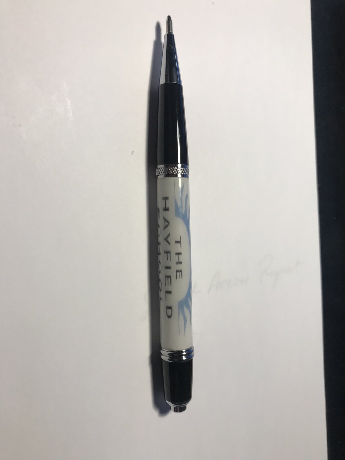

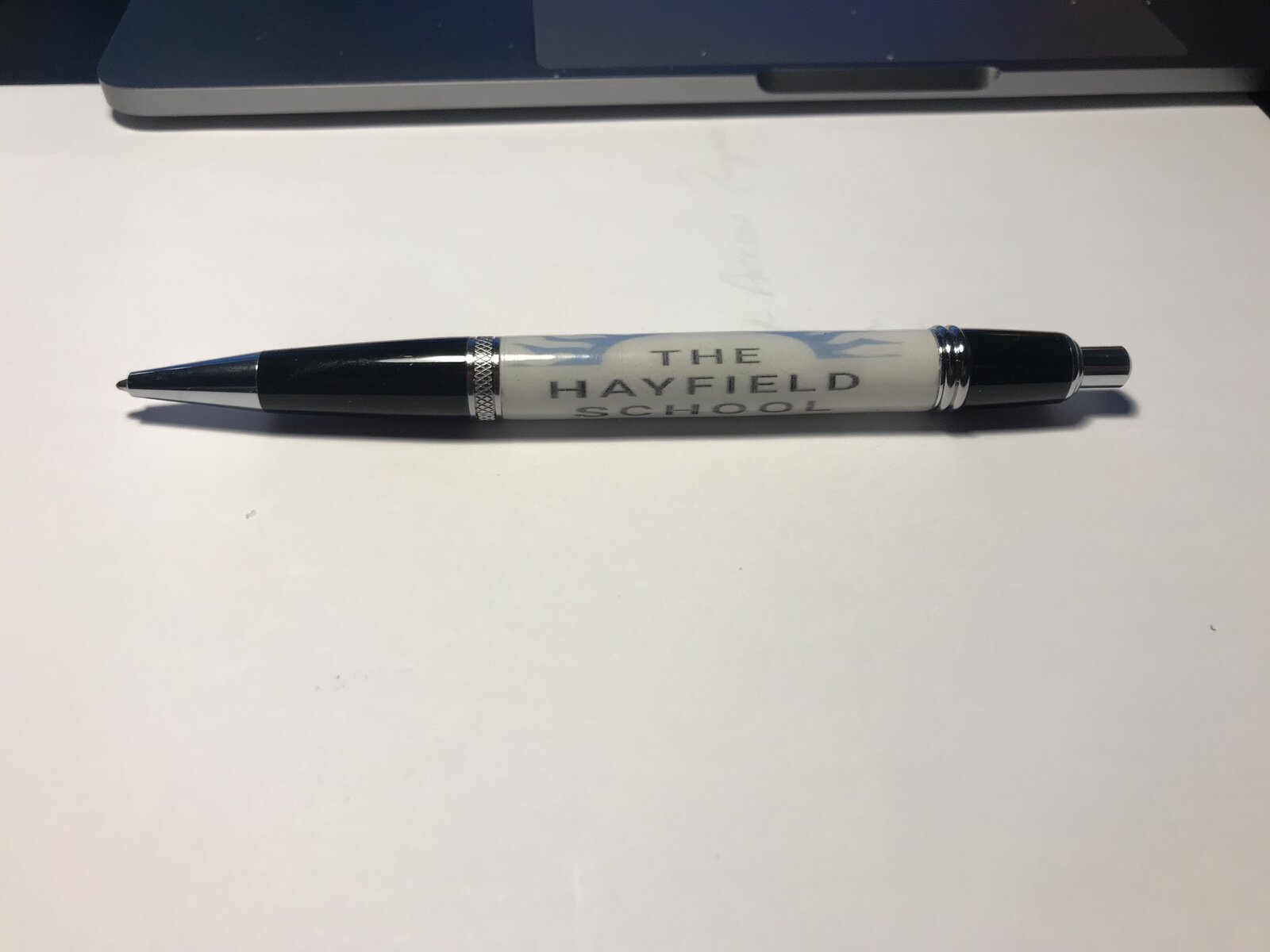

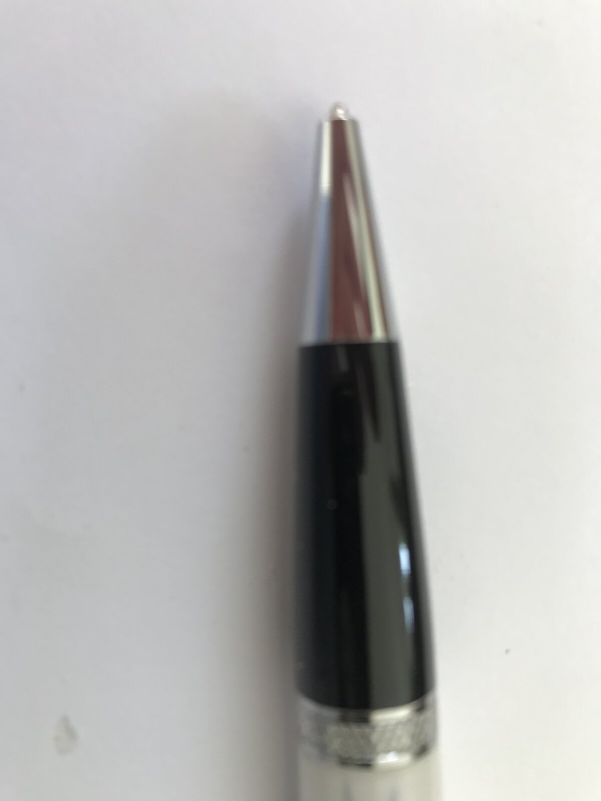

One of the two is fine, but on the other, I can't get the nib to retract far enough into the nib housing. The pictures show retracted and forward positions.

It might help if you could please show the complete pen, including the click mechanism's button at the top.

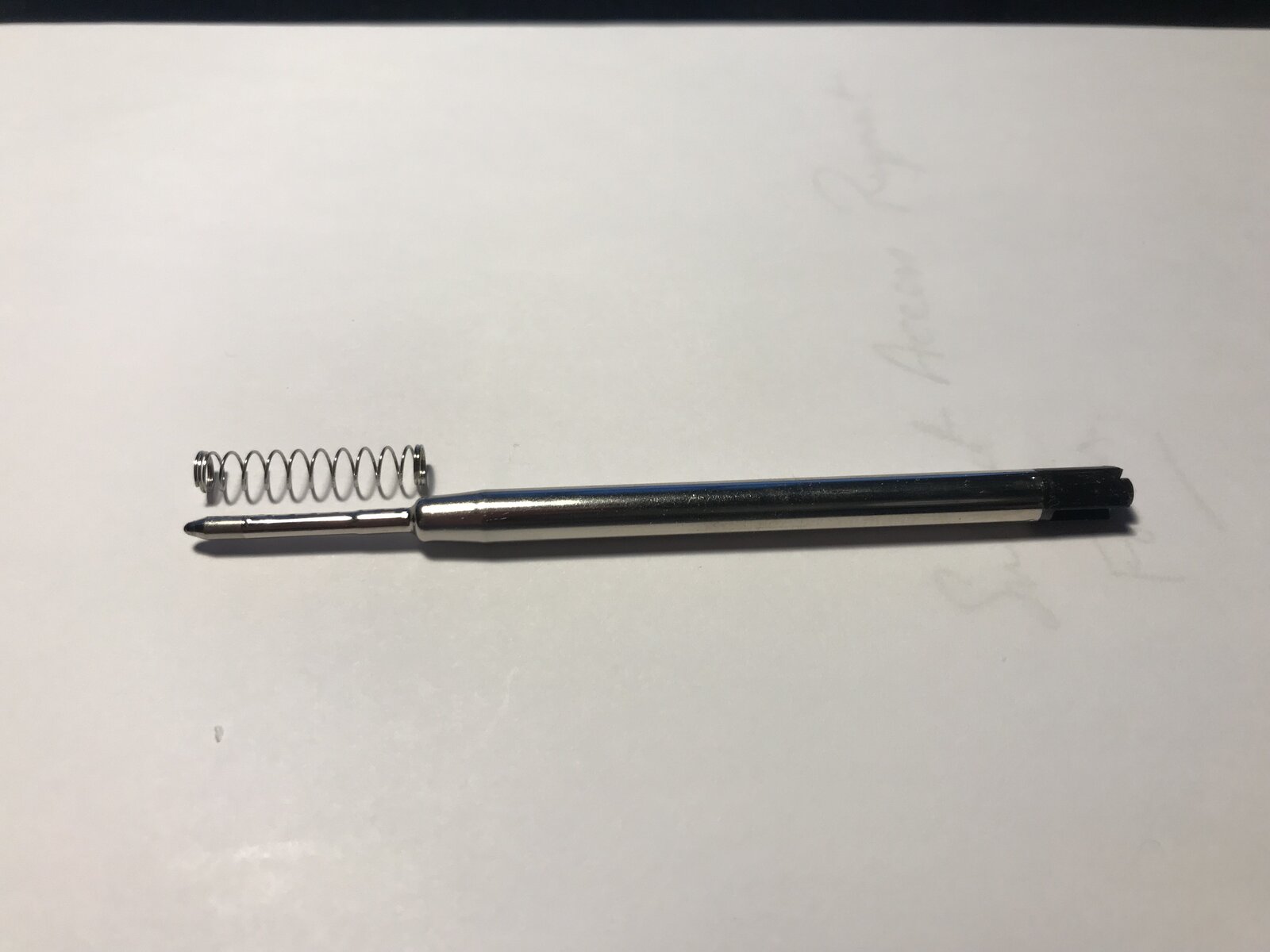

Two pics .... refill retracted and refill extended. . And also a pic of the refill, with spring, outside of the pen.
You said you have made two such pens, one of which is OK. .
How do the lengths of the two refills compare ? . There is a Uni-ball refill which is about 0.4" longer than a normal Parker refill .

The refill looks just like I hoped it would .... meaning the look of a usual "Parker-style" refill

This might not be it, Mike, but I had something similar with the refill not retracting properly. I found that the nib was catching in the hole in the housing which needed to be drilled out a tad. I have a feeling that this may not be your problem.

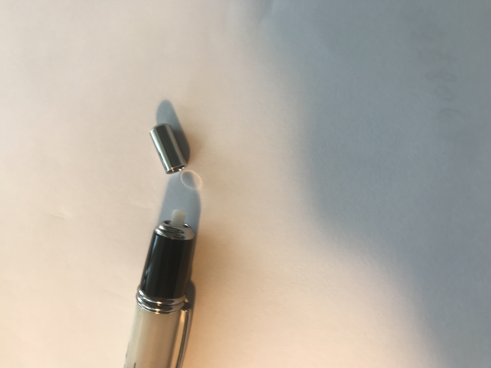

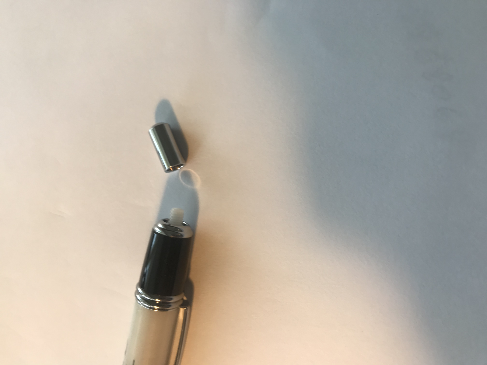

Mal:- Here is a photo of the unscrewed finial. The mechanism doesn't drop out when the finial is removed, but I thought that if I jiggled it about ( note how I have acquired pen turner's vocabulary!!) it may resolve the problem. I started turning pens in 2015, but I don't think I came across the Sierra until 2018.

Mike,
I now see what you mean by the "unscrewing" .... did not realize it was just the button .... thought it was most or all of the whole finial.

Sorry about the confusion (again). In my instruction sheet it is described as the finial and not the button. The white bit is one of the 3 parts of the mechanism and the finial (button) screws on to it, but I agree it all comes ready assembled with the clip etc. for pressing into the tube with a block to protect it.

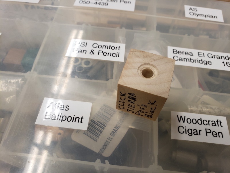

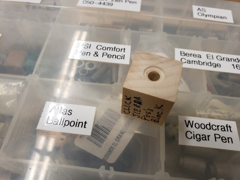

To Join the Thread; Never press on the clicker button when pressing in the blank. Make a push block to avoid pressing on the clicker button and mechanism. Drill a hole in a scrap (1" or 25mm long ) just a bit larger than the clicker in the top of the pen. If you want, you can also make a "relief" with a larger drill bit.
I always use a block for click pens. It sits in a special place near my workbench
