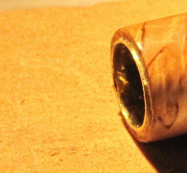

Had this exact phenomenon happening several times with wood pens: the tube is exposed on both ends. The last one was yesterday with an Artist Sketch. The first times this occurred, I also concluded (somewhat sceptically for I inspect my blanks before sanding) that the pen mill was responsible for this. But the last time I noticed that the blank heated while sanding.
My thougth after this: if heat is the cause, the tube protruding could also occur during the finishing process with CA glue.
Conclusion: avoid too much heat.
What size tube was it? 7MM? I had a similar problem and found out it was my pen mill head. There was just enough clearance between the 7mm pilot and the head for the tube to go into the void. Every 7mm blank I squared off with this head left a little bit of tube sticking out the ends.
15/32" for the Artist Sketch.
If I had a problem with the pen mill head, I presume I should have a tube protrusion issue with every blank, at least with the same tube diameter.
From the last batch I checked another (finished) Artist Sketch: no problem. I also checked some Statesman (not finished yet) lower tubes which also need a 15/32" drill bit: no problem.
But on this specific Masur Birch blank (glued with Gorilla glue and finished with CA) the tube is protrudring on both ends...

Attached is a picture of the protruding tube on the Masur Birch / Artist Sketch blank.

Jim; On 7mm brass tubes & blanks I have seen the brass deform and get between the cutter and pilot of the pen mill. The result is the brass sticks out beyond the tube. I prefer a sanding jig for trimming blanks for this reason.

A lot of shrink indeed. I checked some Masur Birch blanks from the same batch: 8-10% humidity. The fact is that birch is very sensitive. More precisely, if the blank did really shrink from heat, produced by sanding or finishing; that is if such a phenomenon is possible, birch is one of the woods more prone to this shrinkage.

I've also seen the brass deform on 7mm tubes. But nothing to do with the picture above. Furthermore, another Artist Sketch tube (with a Maïdu blank) from the same batch was just fine. Also, no problem with other similar tubes (different mechanisms but same diameter) like Statesmen or Emperor lower tubes.
As for the pilot mill head cause, is it possible such a shrinkage could go unnoticed?
1° All of us stop milling when the brass tube is flush with the wood;
2° Assuming the protruding tube appeared during the milling process I'd rather had stopped instead of persisting;
3° Assuming again that I incidentally insisted. Who can imagine I only did notice this kind of tube protrusion (on both ends!) right after finishing the blank?
