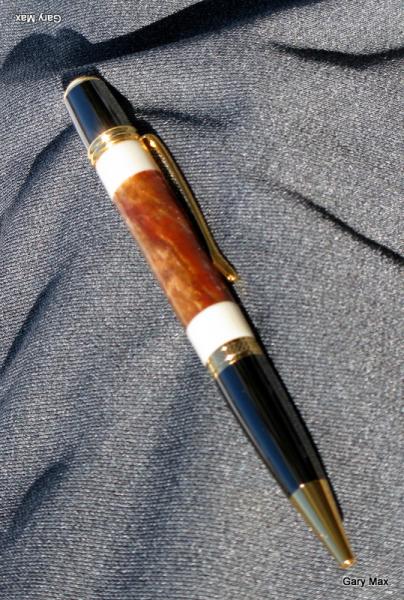

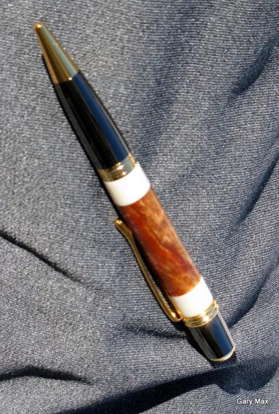

I started this yesterday but it wasn't happy so I gave it the rest of the day off.
This morning the shoushan stone was acting better.
This pen is made of REAL stone-----Shoushan Stone
This stone came from Tibet

How did it drill and did it dull the tools much...?

I would guess most of the stone your are seeing at the malls is Marble of some sort.
I bought some diamond drills that should be used with water---I was just playing around yesterday and drilled this blank dry and slow.

The white material I used for banding------Alt Ivory from my friend Ed Brown.
Super nice material to work with-----makes a cushion for the stone.

Beautiful Job Gary! I've turned a couple out of some soapstone I got from NewLondon88. The drilling was not too bad but the turning was tough. It ate carbide like I was trying to turn a file. The sandpaper hardly touched it. I'll have to give it another go with some ceramic cutters.
