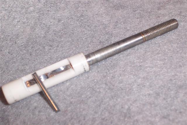

When I made the herring bone pen I nneded a couple of pin chucks that were odd sized.
I made them from a bolt and corian.
( I don't think it will put fangar out of business.
The 1/4 28 bolt fit in the M@ adapter sold by Berea

Originally posted by alamocdc
<br />Oscar, just remember, if you cut the mandrel to your desired length, keep the fall off and make a pin chuck for turning 7mm closed ends. [;)]
A 7mm mandrel does not leave much room for a pin[;)]
