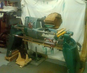

Recently I've seen several postings from people with Shopsmiths or asking about them, so I thought it might be fun for some of us to chime in and touch base with each other. Take a moment to speak up on how your using yours, upload some photos and show off yours, just whatever. It's another thing we have in common besides making pens!

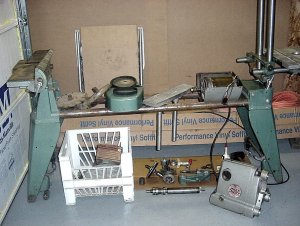

With that in mind Here's some photos of mine from the time I got it until as recent as a year ago. When mine joined me, it was in April 2004 (based on the date of the photo, I've forgotten the exact date) and was purchased for $50 at an estate action and was a basket case as shown here.
After a summer of collecting parts on ebay and some new internal parts directly from Shopmith, I was ready to spend the winter rebuilding. I was sandblasting and repainting EVERYTHING paintable, buffing and polishing the aluminum parts, replacing the way tubes that had rusted too bad to polish up and scrounging ebay for various missing parts. Finally a year after I brought her home she was like new and ready to rock and roll!

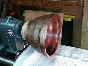

The biggest workout the old girl has had to endure so far has to be this huge chunk of walnut that started out about 13 inches across at this largest dimension. The SS speed reducer between it and the headstock was a must, to drop the turning speed down to 100 rpm for that big beast.
The SS endured well and this 11 inch bowl was the final product of that big hunk of wood.

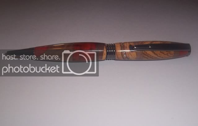

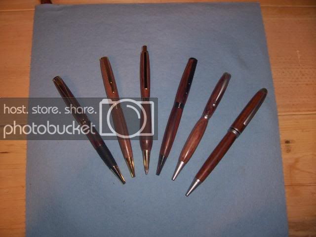

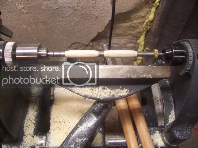

Mostly my trusty "Greenie" keeps busy making smaller pieces of wood go round and round so I can make pens out of them. Here's a couple pieces of ebony mounted on the mandrel that's just past rounding and on to the shaping stage. Note below the wheels at the base I've made some 4 inch risers for it so I, at 6 ft 2in height don't have to bend over so far when turning.

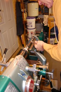

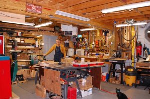

Here's a shot of me posing with the Shopsmith, surrounded by several of the other tools in my shop. My trusty bright-eyed companion, Kdos, is not to shy to be in the middle of things and wondering what the heck "daddy" is up to now.
And every vigilant and ready for the next job in April 2011, the old girl has been serving me well now for almost 7 years now. The past 3 1/2 almost exclusively for turning pens and bowls, and powering the bandsaw attachment.

Bought mine in 2007 or 2008 it has been used to remodel my house and now it is used to make my pens I will never get rid of it but I am going to buy some other single use tools so I can be a little more productive. I found mine on craigslist for $300 had to have it.

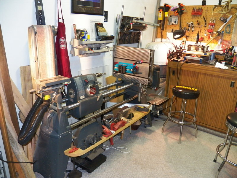

Here's a pic of mine. I have most of the attachments including the dust collection system. I use it for my horizontal boring and sanding.

Nice setup Ron, looks like your set up to slide the headstock back and forth between sanding and horizontal drilling!

I like that setup Ron. I was trying to use mine for the drillpress, but had no room to add the table and raise the tubes. I never thought to mount the vise as if I was going to drill from the top-but instead use the horizontal boring feature.
Thanks Mike. This is the way I have it set up most of the time. I can easily swap the band saw with the sander if I need it. I am very limited for space so it works out good for me. At some time I will post my "mini shop" photos!

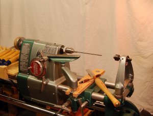

I know this thread is 5 months old, but since it was linked to in a post today, here's my Shopsmith story...
A broken 1955 Greenie was given to a friend of mine who is a cabinet maker. It sat in his shop for a few years. He never got around to fixing it up, so he gave it to me.
I replaced bearings and belts, added oil holes to the early-style sheaves that had no holes, drilled the access hole on the back side of the headstock, scrounged some parts, casters, etc online.
Some of the more unique modifications I've done was to pack the tubes (way and bench) with used lead wheel weights from a truck tire shop. It adds quite a bit of weight and dampens vibrations. I highly recommend it. The only downside is the increased weight when going to drill press mode, but for me it was worth it.
When I had my motor apart to replace the bearings, I chose to snip and solder some wires and add an extra switch to make it reversible for sanding. It also allows me to run SPTs such as the belt sander and bandsaw on either end of the headstock.
Even with all the work I put into it, I chose to keep the original Gilmer belt drive setup. I did restore and test the slip clutch. Someday I would like to add a second bearing to the quill, but as it is, I get less than 0.001" of runout so I'm quite happy.
I have a 1955 Greenie with jointer, bandsaw, planer, jigsaw and beltsander. I use a Nova G3 chuck to drill my blanks. I used to clamp them to the table using the mitre gage and drill them that way, but this is faster and more accurate. I chuck the mandrel in the Jacobs drill chuck and use a 60 degree live center. I haven't tried TBC yet, but it's on the list.
The next thing I need to do is get a shorter tool-rest. I'm thinking about cutting down an old spare that I have instead of buying the short 4" one from Shopsmith.com.
Notice the extra reversing switch in the picture.

Nice use of your old "Greeinie"! I like your idea of the reversing switch in particular, I hadn't thought of that, but it would be great for sanding larger items like bowls and such.
Thanks for sharing!

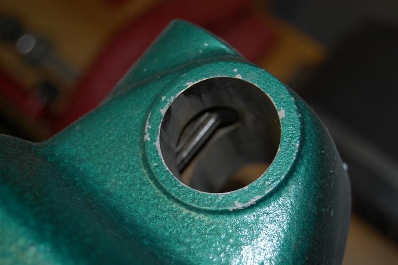

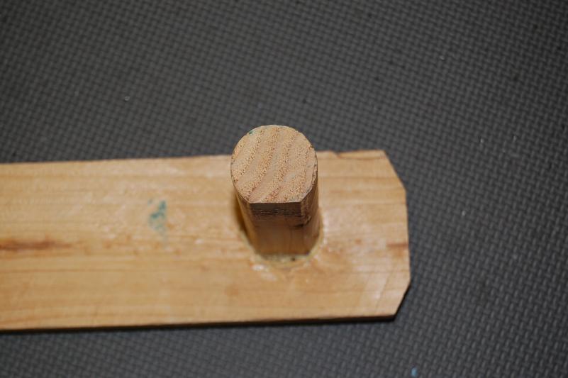

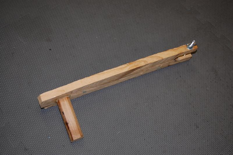

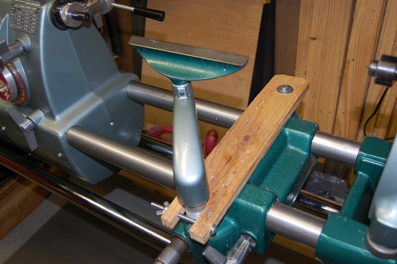

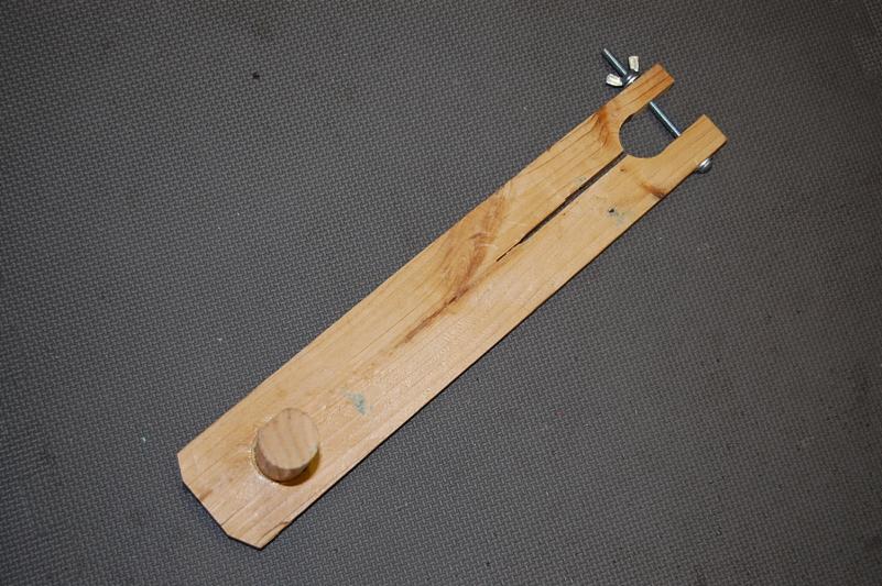

Well, since we got this thread reincarnated, lets pose a some questions/solutions that might help one another. Here's the first the first thing I did when I started using the lathe:
Have you ever had problems keeping the rest in place while turning, rather than drifting into your work, since the base of it doesn't lock in place?
Here's some photos of the solution I come up with to keep the pesky thing in place, and it's been working great for almost 4 years now. One end clamps around the post of the tool rest, while the other end has a dowel that fits snugly in the hole on the opposite side of the carrier, with a notch to clear the gear inside the hole:
It looks like you came up with a great fix.
But I have to say that I haven't had that problem. Is your problem that when you set the height of the tool rest and tighten the lock knob that the threaded tool rest post still rotates? Does it lock tight enough that the height adjustment lever stays in place?
Yes my problem was with it rotating. The locking knob locks the height in place, so it doesn't raise or lower, but it doesn't prevent the arm holding the rest from rotating, thus the reason for my solution. I don't know if newer Shopsmiths have the problem as maybe they engineered a fix for it. but my old circa 1954 model did.
Here is a picture of my 1955 Greenie tool rest post and arm, and a 1980's tool rest post and arm (wearing the actual Greenie toolrest - that seems to be the straightest combination of the mix match of parts I have on hand). The threaded rod on the Greenie is permanently fixed to the arm with no movement at all. It looks like a press fit, or maybe some brazing or something. There are no set-screws. The newer 80's version has a set screw so that you can swing it in and out without affecting the height adjustment.
I wonder if your '54 was made the same as my '55 and has just come loose through the years, or if there was a design change between those two years.
