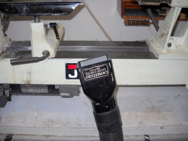

This is the magnetic base vac attachment I use. I don't worry about the chips/shavings too much -- just getting vacuum hose close to the work so I can clean shavings off the tool while I'm turning. I do pull the hose and put next to the blank to collect dust when I sand. DC system worth buying if you do other types of woodworking though.
