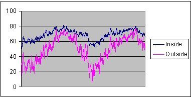

Between the floor mats and the oil filled radient heater (1500 watt) my garage stays tolerable in the winter. I only run the heater for a few hours a day. I have it on a timer to turn on an hour before I head out to the shop in the morning and after work. It turns off on the timer after I leave for work or go to bed.
To get a picture of the temperature profile in an out I have the follwoing data (Temperatures measured first thing in the morning and just before bedtime)

In my case, I know that I will be in the shop a bit in the morning and a bit in the evening, so have my heater on 5 hours a day. I run the heater from mid October through mid April, with it on low (700 Watts) for two or three of those months, so I spend around $175 a year to heat my shop in CT.
On a bitter cold day (single digits F outside) the shop will be upper 50s, most of the time it is in the 60s.
