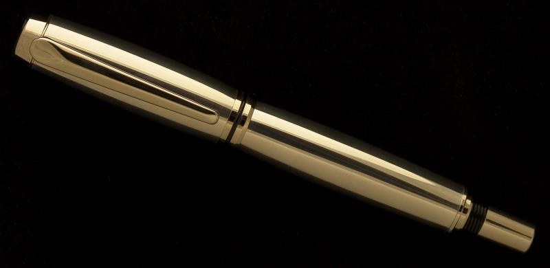

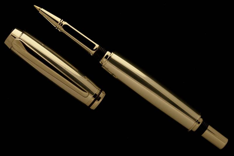

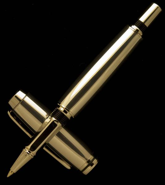

Turned this last night and finished this AM. One of John Goodin's aluminum blanks on Platinum Navigator. Turned with carbide tools, sanded to 600 grit, MM (wet) from 1200 to 12000 grit, and finished with Brasso Polish followed by a coat of RenWax. Just looked like a "shiny thingy" to me. :rolleyes: Hope everyone has a great weekend. As always, thank you for taking the time to look. Doc:smile:

That pen works really great! Do you have to do anything (finish) to the aluminum so that it will keep it's shine?
Great job Doc , very shiny !!! I love my aluminum pens but the fingerprints drive me crazy !!! Try using some "0000" steel wool and make a brushed satin finish , no fingerprints and it sets off the shiny Rhodium furniture beautifully .
No, but sure thought I would. The only thing I've used is a wax which is what John recommended. This is the second aluminum one I've made and I've carried the first one and it's still as shiny. With the RenWax, I have had much in the way of fingerprints.
Butch, I think I will try that. With the RenWax I haven't had much in the way of fingerprints which was a surprise to me. Nevertheless, I would like to get the brushed satin look you describe and will do that on another set of blanks I have. Thank you for the feedback!! Doc
