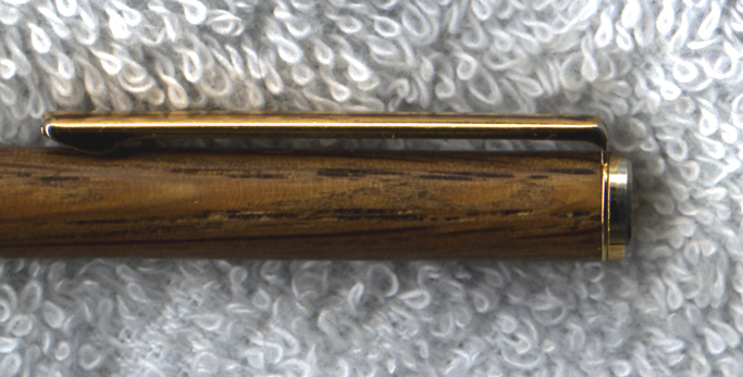

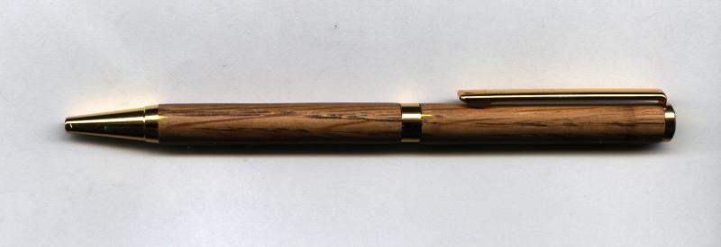

Here is a new vs 2 year old pen (same pen) to show the darkening of the finish with shellac and wax finish. The finish darkens and it always seems slightly tacky, even after 2 years.
I did this once and will never use the finish on a pen again.
