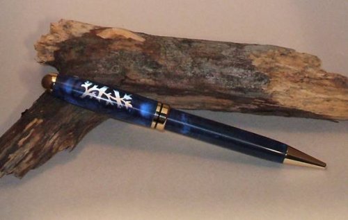

There are many way to do this. I way I like to do them is to glue the inlays to a tube or built up tube and cast around them. You can buy precut shapes from people like luthiersupply.com or cut them from shell blanks with a jewelers saw.
Here's one I did about 5 years ago with that technique.

I see...so it seems you do a resin cast tube then rather than doing an ingraved inlay?
I've done it both ways, but casting around the inlay gives a much cleaner transition. Its also possible to laser, scroll saw, or hand cut the pattern in a wood or plastic blank and fit the inlay.
