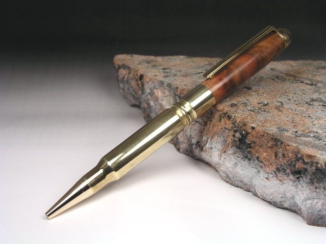

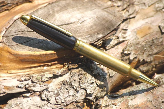

I use 300 Winchester Magnums. The seem to work and look the nicest in my eye. The 308's are small in length. To make the pen seem like the right length, you need to make the upper portion longer. Without the proper shape, the upper barrel is hard to make look right. I like how KnottyHarry does them though. Here is a 300:

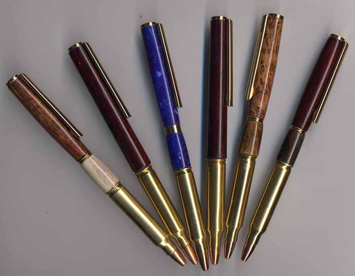

Here is what I have done with the .308's.
Most people here said they did not like the way I used the portion of the .308 for the centerband area. I tend to agree. However, the 308 was too small overall length without it.

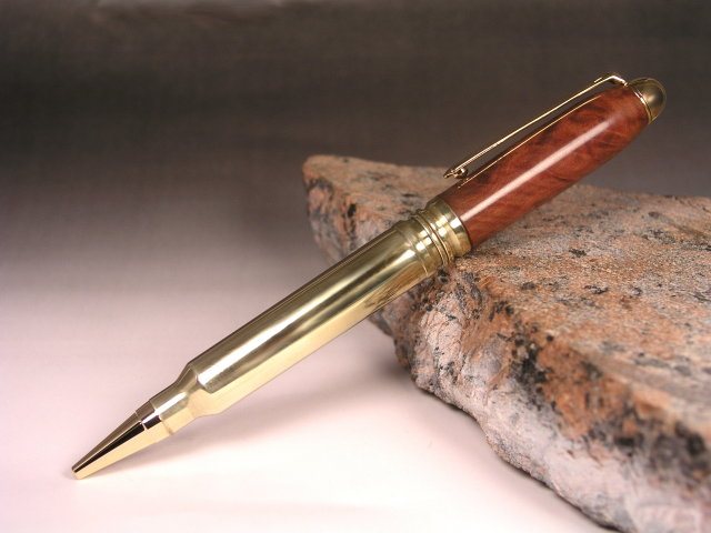

Here is a 300 Win Mag with a Euro Finial:
30-06's are nice too, but I haven't any photos of the ones that I have made.

If you are using any casing that is too long, and are using a 7 mm kit, the way I make them you can turn a tenon on the lower portion of the top barrel and it will fit nicely into the casing.
It shows craftsmanship and adds to the strucural integrity of the pen.
Of course the casing needs to be drilled accurately on center for this to work.

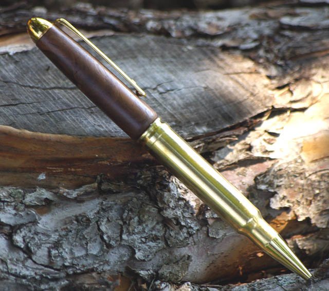

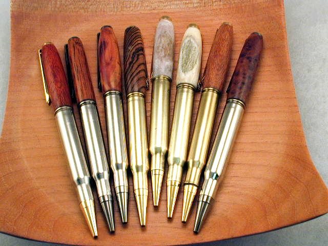

Here are a couple of mine. A .338 Winchester Magnum with walnut upper and a .340 Weatherby Magnum with water buffalo horn upper. I prefer to use the euro kit over the slimline. I also use .30-06 casings with a slimeline nib and the euro parts for the upper barrel.
