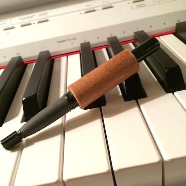

A letter W drill bit seems to work ok for the barrel. The threads measure very close to 2.0mm and are shaped much like the black piano keys in the picture but they are very shallow maybe .009 of an inch deep if that. Following is a photo of a test barrel I put together.
Ok, the letter W bit was ok for the wood blank but it was too big when used on an acrylic blank. A letter V was needed for the acrylic blank. So, if anyone is doing one of these start with a letter V and go from there depending on the material.
