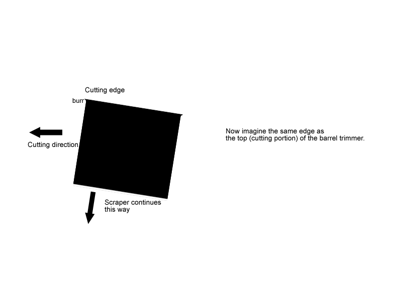

I've actually been using a diamond hone on both flats of mine, but this thread got me thinking. All of the instructions I've ever read for sharpening a scraper (crucial tool for fine woodworking) have you leaving a burr on the cutting edge so the tool will cut better. It makes extremely thin shavings if you do it right.
<br />
Having said that, it makes sense to sharpen the flat on the "top" of the trimmer.

I can see your point, but I think you are not scraping you are cutting. I think that they want you sharpening the vertical face is so you do not mess up the angle on the horizonal face.
alamocdc
Apr 26, 2005
7,970
San Antonio, Texas, USA.
Yes, Mike you are cutting. That's the point. It works much the same way as a plane in fact. But the fine burr is what actually gives you your cutting edge. On the barrel trimmer if you had 2 edges at near 90 degrees without a burr, you wouldn't have much of a cutting edge. You'd have more of a tearing edge.

<br />Yes, Mike you are cutting. That's the point. It works much the same way as a plane in fact. But the fine burr is what actually gives you your cutting edge. On the barrel trimmer if you had 2 edges at near 90 degrees without a burr, you wouldn't have much of a cutting edge. You'd have more of a tearing edge.
I read this several times trying to figure out how the statement about leaving the burr on made sense. No offense intended. But leaving the burr on any cutting edge is undesirable. With turning tools, it is unimportant. A second of turning and the burr is gone. But with cutting tools (chisles, knives, barrel trimmers, etc.) the best result is with the burr, or wire edge as some call it, honed off. I learned this from wood carvers and master knife makers. The best cutting edge is after the burr is honed or stroped off. In fact, wood carving is nearly impossible unless the burr is stroped off. Ask old time barbers, if you can still find one, what the result would be if they gave a shave after sharpening a straight edge razor but didn't strop it. The result would be pain and blood. Pick up any instructional book on sharpening, wether it be knives or tools, they all advise removing the burr edge.

Eagle, you beat me to it, but the point about scrapers is made. I was not intending that a wire edge be left on the pen mill. I was simply drawing an analogy between the edge that's cutting and the edge that logically (to me) needs sharpened. Based on the posted experience of others, my logic may be illogical. One way to find out is for me to try it both ways and see which one works best and longest.
