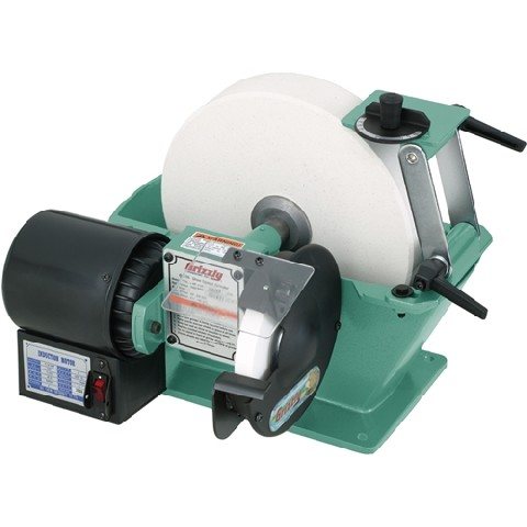

I am new to this whole endevor. I understand the importance of grinding at slower speed.
My question is how would this grinder compare or would it be worth purchasing to sharpen your lathe tools? It seems pretty reasonably priced at $149. Any input would be appreciated.

The link for the grinder is here:
http://www.grizzly.com/products/item.aspx?itemnumber=G1036

rfreeouf: I have one of those units on my sharpening/grinding island. When I bought it, I thought I had achieved sharpening nirvana. Not so, it sits there looking useless, which it is nearly is. The big, slow, wet wheel is so fine grit it barely polishes an already sharp edge. Plus it's a bit messy to use and requires maintenance. This same unit is sold by many vendors under different names. e.g. Grizzly, Delta, etc. Save your money.
