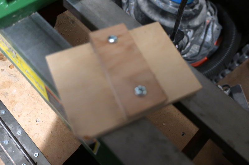

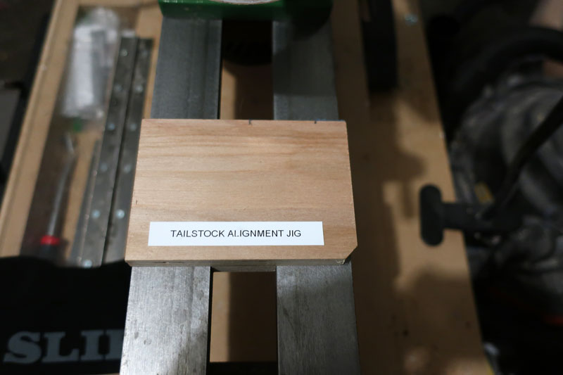

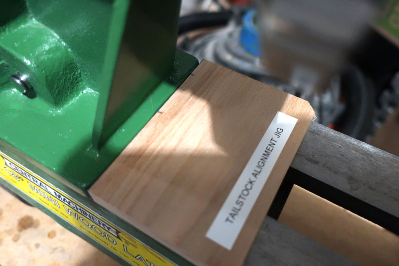

To get the play out of the tailstock and eliminate that as a possible cause, I cobbled together this little jig this morning out of 1/2" plywood. The jig fits to within .005 inches between the ways, and the front was shimmed with layers of tape resulting in less than .01 inch side-to-side movement. We'll see how well it works for drilling later today. Excuse my poor photography (especially on photo 3) - :rolleyes:

PROBLEM SOLVED - The jig reduced the shake, but didn't get rid of it. Further troubleshooting showed that the bolt on the motor pivot arm had backed out by 1/2 turn - yes, 1/2 turn! And THAT, my friends, solved the shake problem for now.
