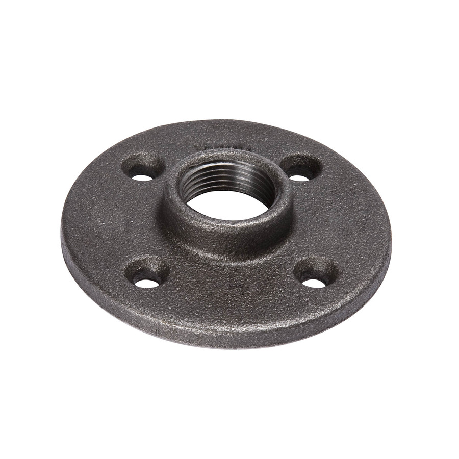

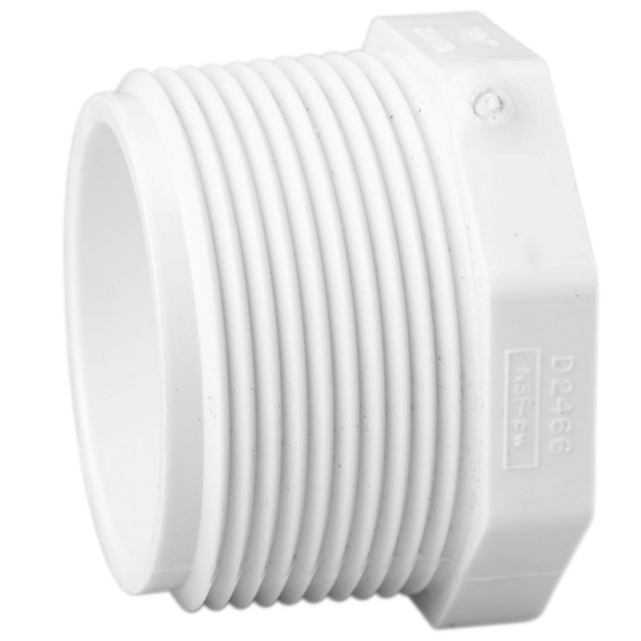

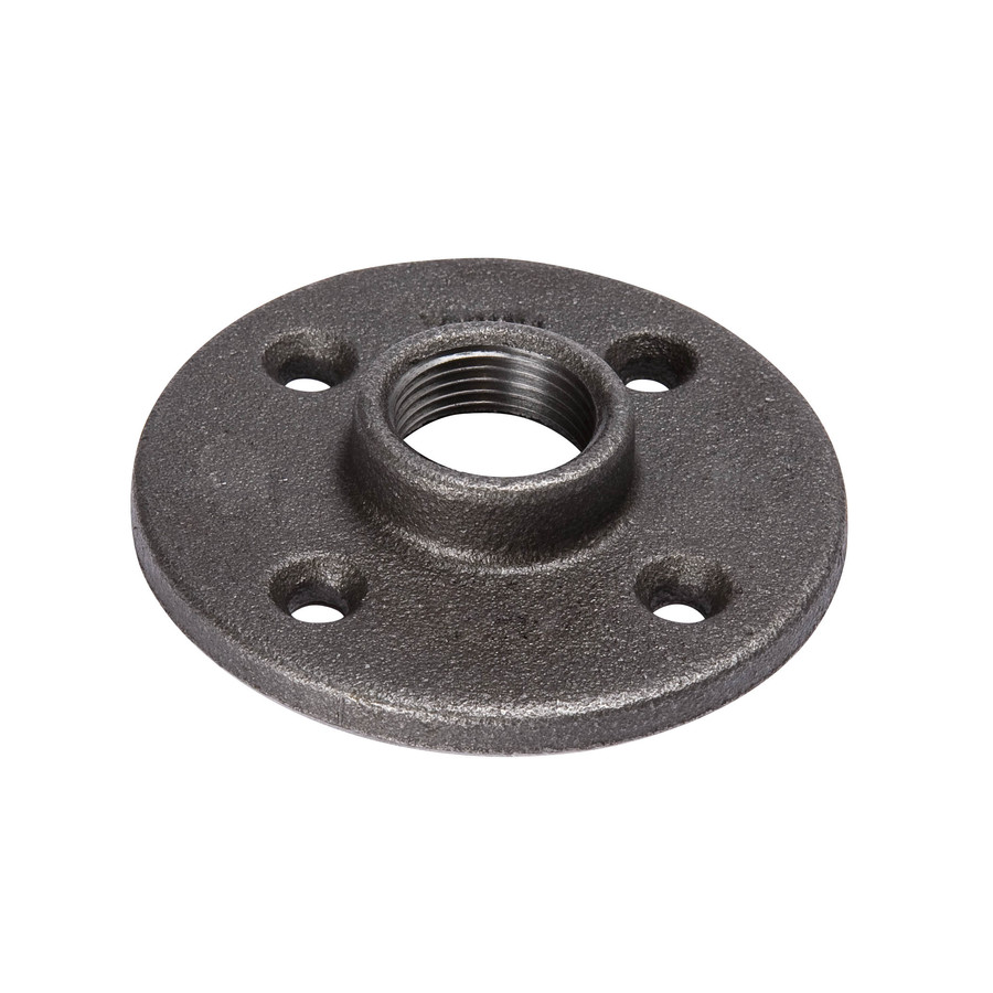

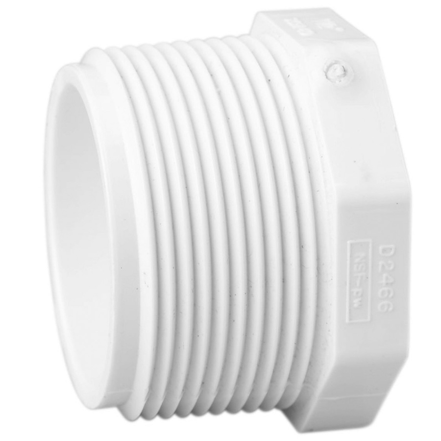

This kind of fitting could be screwed to the ceiling. Then use a pvc threaded couple.
