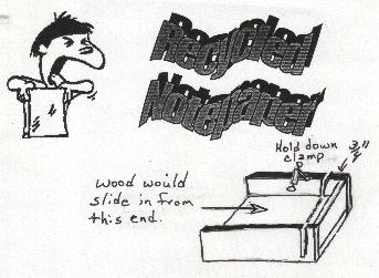

Since I assume we're talking about hand sawing here (probably with a backsaw) I think it can be done but using an open ended miter box idea. I don't have a CAD package so I hope this scan of a hand drawn sketch will work.
<br />
You could glue sandpaper to the bottom board as well to hold the wood in place.
Another idea would be to move the two slotted walls to the outer end of the floor, either side by side or divided with a spacer. That would give you, at least, an inch and a half long guide slot(depending on the thickness of the contruction lumber) and allow you to use longer strokes with the saw.

There is a pattern for a jig for the band saw elsewhere on this site that's better than my sketch. I was thinking hand saw as the bottom of this box would need to remain solid for it to hold together.
If your talking power saws the above sketch could be modified with a couple of guide rails on the top to allow a circular saw to be run on a parallel line to the end piece (stop block). The side walls height would be whatever it took to allow the blade teeth about an 1/8" penetration into the bottom.
