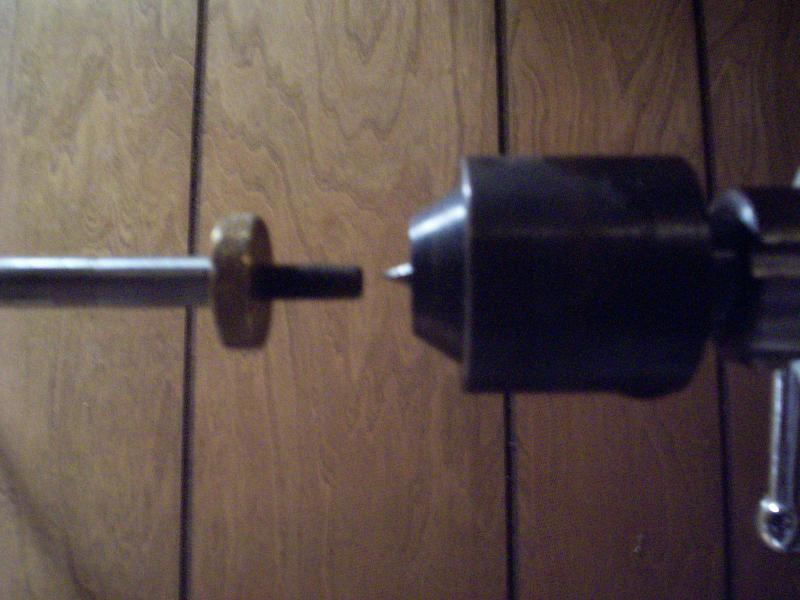

3. i have attached a bad picture but i hope it illustrates what im talking about. this problem is apparent even without attachments like a mandrill

now that i have reviewed the parts manual i can talk in a languege you all can understand. the spindle shaft/hand wheel assembly is the issue. the tail stock if anything straightens out the mandrill.i am very carefull to not over tighten it

If you put a dead center in you headstock and move the tailsock up close do the points of the dead center and live center look in line? Rotate the headstock by hand and see if the tip of the dead center runs true. Use the tip of the live center as a visual reference.

Acornelius, the dead center does not line up with the tail stock, when you manualy spin it you see that the dead center goes up and down.

As suggested put a dead center in the head stock and move the tail stock with live center so they are tip to tip, they should align perfectly. Looking at your picture the center of the mandrel doesn't line up with the live center, I bet the dead center will yield the same result. If this is true you'll need to align the tail stock to the head stock. You did mention it was a new/different tail stock, this is probably when the issue started.

Hey everybody!!!! Look at the picture shlomo included of his mandrel and tailstock. He needs to get a 60-degree center before he does or tries anything else.

i agree with studioso. if a dead center is going up and down while manually turning the headstock spindle i believe dirt in the morse taper is the culprit. i also agree that he needs a sixty degree live center for his tailstock.

YES!! I had this problem just a few weeks ago. Out of round pens and a dead center point that "orbited" the live center point when turned. I cleaned out the morse taper, and all is now well.
