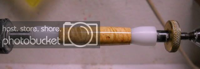

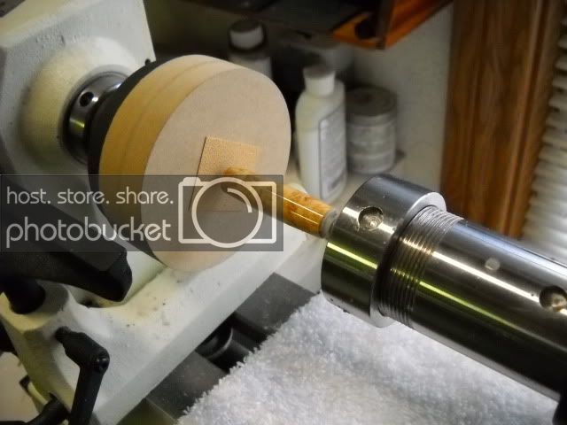

Ditto re problems separating bushings....you can also buy these Eliminator bushings from John at penturnersproducts. You'll still likely need a method for removing CA from tube ends -- I use 120G PSA discs cut into small squares for mine.
Eliminator bushings:
My setup for sanding CA off blank ends (mandrel rod with pen mill sleeve in collet chuck -- Jacob's chuck in tailstock should also work):
