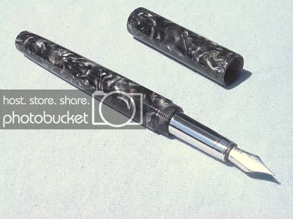

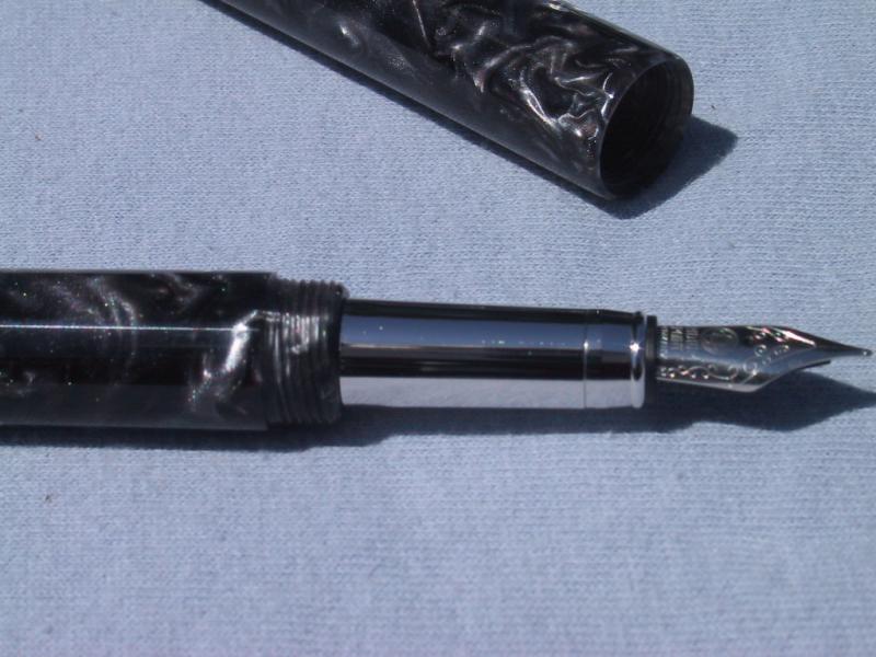

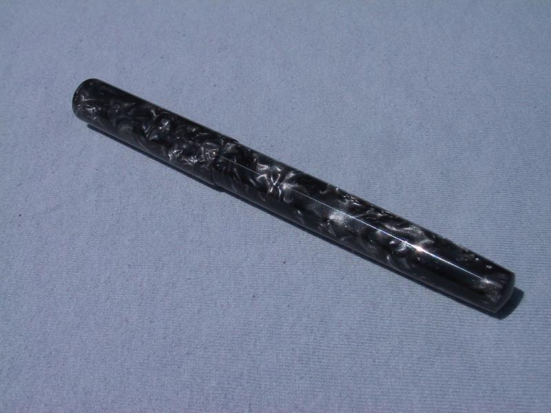

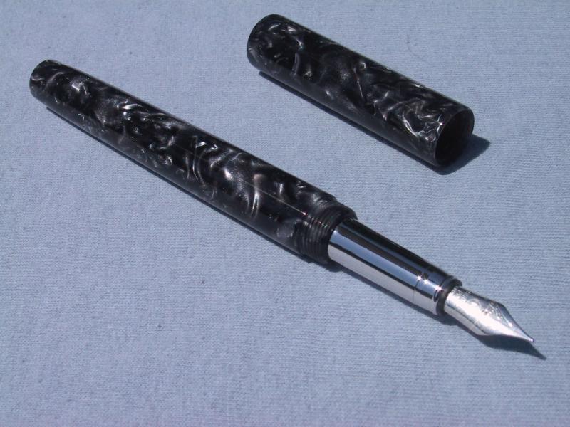

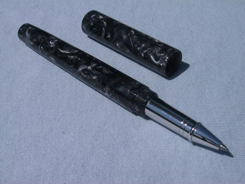

My first picture post. Yes, my photography leaves much to be desired. One thing at a time. Like many others I got my triple start tap and die from the group buy (Thanks again Joe).
It's my first try with it but it didn't come out too bad so I figured I'd post it, right? I fitted it with both a rollerball and fountain pen nib because I couldn't decide which one I liked better.
Mike

Nice job Mike I like the rollerball look but the Fountain pen is my favorite. Your pictures arent that bad..

Cool! Now we know the tap and die work!
Nice pen! What's the material?
- Joe
The tap and die worked very well Joe. I expected more drama on the first go around. It was a slab about .700 thick that I've had around for longer than forever. I ripped off a piece on the tablesaw then turned it into a rod to get me started. I'm really not sure but I think it was called Crushed Velvet. I don't have a clue where I got it. I think it was given to me.
I know and use tap and dies. But what is a Triple tap and die? Not familiar with it. Enlighten please. Russ
Triple start threads are what are on all the high end pens, to couple the cap and barrel. There are 3 starts on them instead of the single start of a normal tap and die. It gives you a fine thread with a steeper pitch so it takes less turns to screw the two parts together. I'm sure someone else can explain it better than me.

Did you thread the outside triple threads first or the inside 8.4 threads first. Others may wish to know as well.

Great looking pen Mike! I'm just not crazy about the grip, it just doesn't fit right with everything else. You know, you can unscrew the nib section and pull it out, then chuck that grip and spin it down thinner, then slide a piece of acrylic over the top of it to totally cover it and give it some shape. I'd put some tape on the threads of the grip, chuck it in a collet, and use the tailstock on the other end, and a woodchuck scraper will peal that soft metal right down quick. I can see by the shoulder where the grip meets the cap threads, you have tons of nice working room to beef up the grip too. When you do higher end shows, customers that are deep into fountain pens, like a grip shape that won't slip out of their fingers..like the El grande style kits use. That's my comments...the craftsmanship you put into the non kit part looks superb!
Mike
I threaded the inside 8.4 first while it was a 5/8ths rod. Then I turned the tenon down and cut the triple threads.
Mike
Thanks, everything you said is correct. This was just a prototype to work out any bugs with the triple start set. Figure out hole and tenon dimensions, get a feel for how much "meat" was left between the inner hole and threads and the triple start threads around, cap to barrel fit, etc.
But once I got that far I figured why not just finish it into a working pen. Get a feel for the weight and balance, etc. I actually screwed up and didn't step drill the cap so I couldn't taper it. Although I didn't think it looked too bad with the straight cap. Now, on to the next one...
Mike
Guys if it's Cuban coffee I might even show up...:wink::cool:
Sorry Roy, I have nothing that exotic, ask Mike R. But he had two cups so I guess it wasn't the worst coffee he ever had...or he was just being polite. You're welcome to bring some though, if you like. I'm sure we'd be happy to drink it.
Mike
