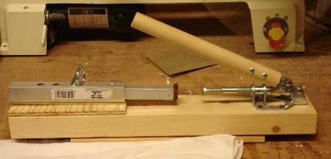

I could not bring myself to spend $30 for a professional pen press. I think I have $10 in this semi-homemade press.

Ron Mc, Yes the holes were placed close to the size of kits. On the "Piston" end I removed the rubber stopper/screw and screwed in a pan head bolt with the head ground flat. I can assemble a cigar and a baron without adjusting the screw. For a euro I let the bolt out or in to get the fit right. If I was to build it again I would put more holes in the top to limit the need to adjust the bolt. I also drilled a small hole in the back to hang on the wall. Flat space is limited. [:p]

Looks good, Chris, but I have to ask. The adjustable square tubing I can figure out, but what are you using for the "press" part(s)? I may be just stupid and don't recognize something simple (probably the case). [:p]

The "piston" mechanism looks identical to the one used in the pen presses sold by PSI and CSUSA. Is this a device you can by at the local hardware store for a reasonable price??
The Lee Valley catalog shows a similar device called a DeStaCo Toggle Clamp; but they are getting $17 + shipping for one so this can't be what you used on your $10 press??

You can find those linear toggles for $10-$12 pretty regularly. I think they were 12.95 at wood craft. I was going to build a press similar to that except I was going to just have a sliding stop block that would tighten with a knob. But then a small arbor press went on sale at HF and that does the trick for me.

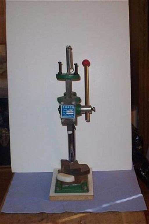

A while back they were discontinuing a variation of an arbor press .I says "paper press" on it)
It took a little adaptation but makes a great press for about $20.00 delivered.

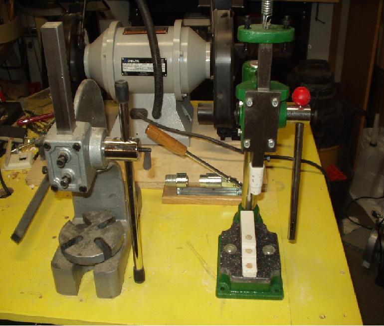

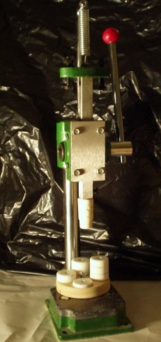

Funny, that was my idea as well, nutcracker, then arbor press, then paper punch press, modified for pen pressing... 2nd photo shows turret on "pen press"... Works Great!

I like the turret idea. I may have to steal oops, borrow that idea.

Yes, the Press/Piston end is a toggle clamp with a dowel attached for leverage. I am thinking about patenting the idea, so I expect a royality check from each of you in the form of an exotic pen blank![:eek:)]

If anyone wants to build a pen press like the one Chris built, there are a couple of DeStaCo clamps available on eBay.....auction #7541041876. You could build 2 presses and sell one here and probably make a few dollars in the bargain.
