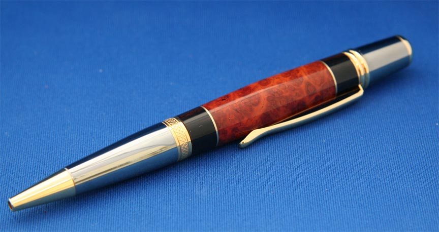

Here is the link to an experiment that I tried (and it worked very well) in which I wanted a larger slimline. I used 1mm thick brass sheeting as spacers.
http://www.penturners.org/oldalbums/leehljp/Slimline%20end.jpg
A pen with .5mm sheeting as a separator in the segments:
Dang Hank, That's a nice looking Sierra. I like the larger slimline idea. I'm going to give that a shot.

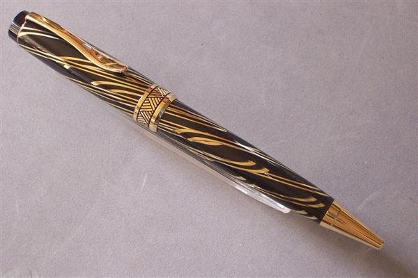

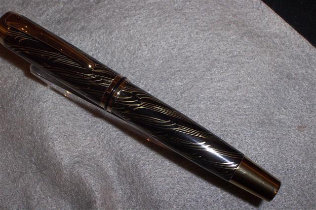

Someone say Brass segmentation; this goes a step beyond segmentation -- hand-made inlay.
These are NOT MINE but are evidence that you can run the brass lengthwise and
not have a problem. Each of these is a true inlay. The brass does not go
all the way thru the blank. The inlays are parallel to one another thus the pattern
repeats all the way around the pens.
<br />
<br />
What that guy with the Jamaican accent used to say?:
Try making that out of a Cola nut. [:D][;)]
