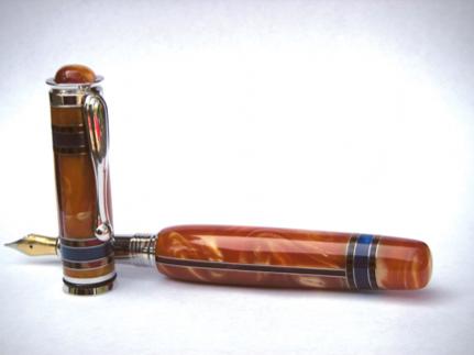

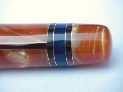

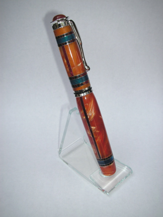

Well folks, here's the finished product. The colors are actually much brighter than these crappy pix, but I must learn how to get a base blank totally square and keep it that way. This pen has some issues with squaring and the bottom piece wasn't drilled perfect so the line down the center just a bit.

Quick update. Sold the pen pictured in this thread for $125 to the first guy who saw it. I'd have held out for a lot more, but the top band wasn't straight and it wasn't my best work. He loves it though! Said he signed a big contract with it today. Nice.
