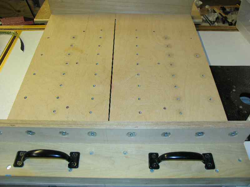

Originally posted by cowchaser
I have no clue on how to build sleds or any of that.
Thanks
This is a photo of my table saw sled. It is about 30" deep and 24" wide. The holes are Tee-nuts used to fix guides or clamps to the sled. See the two black handles? I keep my hands on those while pushing the sled thru a cut.
