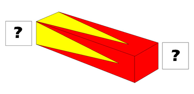

Just for some fun, see if you can figure out how to cut this segmented blank.
When the blank is in the square, the red points reach the end of the blank.
The yellow points reach about 2/3 of the way to the other end.
But once the blank is turned round the length of the red and yellow blanks are the same. The point of the yellows don't move.
I'm busy building this blank now, but it's too late to continue or my neighbours would shoot me ( unless my wife did it first !!):biggrin:
This one can easily be done with a table saw, but mine has wavey diagonals and I'm using a router. Either way, the ends of the blank would look the same and reveal the way it was cut. I just drew it like this because it's difficult to draw wavey lines in MS Paint.
Have a think and post a pic of two squares with the way you believe the ends would look:biggrin:
Edit;; The ends of the points MUST remain sharp and not become rounded once turned!!!

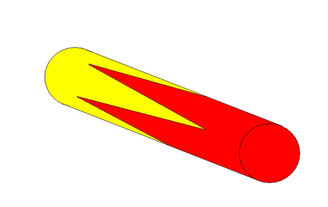

traditional archers make these all the time when footing wooden arrows, i am told there is a jig available for doing it which uses a router, i am sure a google search could turn up more info
it would probably be called a four footing jig
the big difference is the archers do it on round stock to start off with
the main reason for doing this to arrows is to put a heavier, harder piece of wood at the front of the arrow, but the joint has to be very strong to take the impact
hope this helps

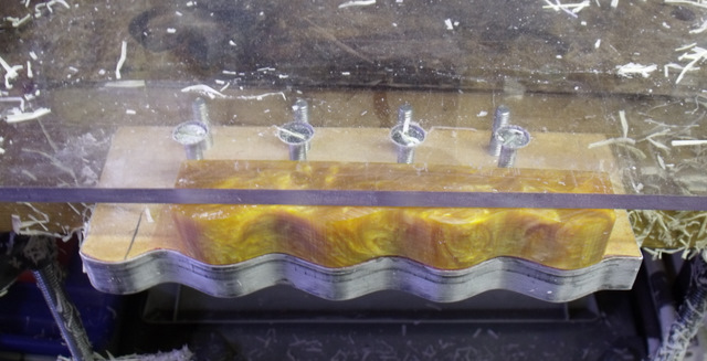

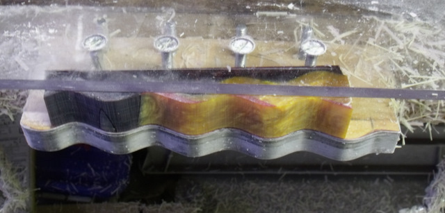

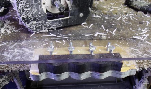

Here's a pic of my router template that I knocked up with a piece of clear polycarb, 8 screws, and a bit of MDF. I just glued a strip of aluminium along the edge to make sure it was smooth.:biggrin:

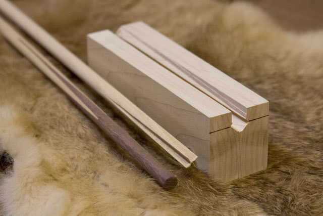

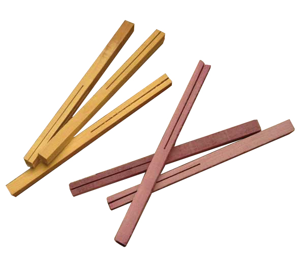

I found some pics of a footing jig that Mik referred to. ( I think :wink: )
It looks very interesting and not too difficult to make. The jig looks like it would make the pale wood cuts and from what I gather, the dark wood is two pieces, each with a split. I couldn't find a jig to do those bits but I guess you could use a bandsaw. I don't know how sharp the edges and points would be.

LOL, see if you can find a similar jig to do the wavy cuts:biggrin:

That is a four footing jig you found but the dark wood is not two pieces, but one with kerfs cut in at 90 degrees to each other. The light wood is inserted into the kerfs and the dark wood is wedged outward and the whole thing is clamped and glued. This is a pretty common way to fix broken arrows or add some additional weight to the tip of the arrow for more durability and/or better penetration and flight.
I have not seen wavy lines done but I have seen spiraled designs, made by heating and twisting the arrow.

the yellow section is actually 4 seperate pieces, and they are all equal thickness fron top to bottom. the red section is also 4 equal parts, but these pyramids are tapered, so they get thicker at the bottom to compensate for the triangular shape of the yellow sections.
Ron, there are 3 yellow pieces and 4 red pieces. There are no compound cuts. They can be cut with either a bandsaw, table saw or in my case, a router ( to get the wavy edges )
I guess you could get the wavy edge with a bandsaw, but I think it's much easier and more accurate to use a router and a template.
Every one of my joints will ( now have ) be done using that template.:biggrin:
I think I understand how 3 yellow wedges can be arranged to produce the pattern. One wedge runs the full depth of the blank and the other two would be glued to the sides of the first one. Not sure how to draw that up so I am trying to explain it.
That would leave you with 4 90 degree pockets that need to be filled by 4 red segments. At first that seemed simple but then I realized that the red segments would intersect at the pointy ends of the yellow segments and would interfere with one another. Do you cut each red segment on two adjacent sides by the same angle of the yellow wedges so they will come together properly?
If this is how you do it does it work well enough that the joints are seemless? Do you use any heat and pressure with resin blanks to improve the joints?
Thanks for the puzzle!
Can I use resin to do it?:biggrin:
I'm looking forward to the wavy blank. You are always coming up with something new.
cut a v notch in the red blank, cut the yellow blak in a wedge and insert into the red. Roll th blank 90dweg and and cut another v notch from the yellow end. Cut a fresh yellow wedge or use the two peices previously cut off to make a wwedge and insert into the notch.

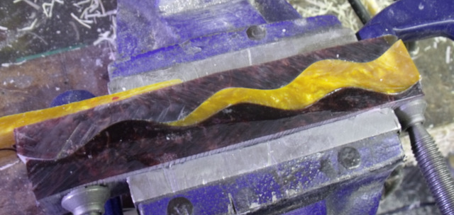

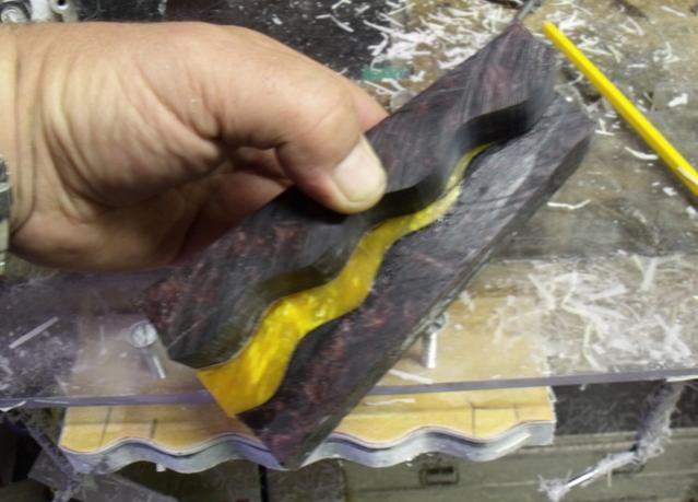

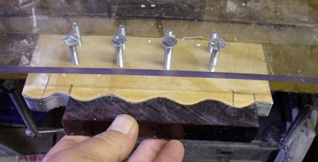

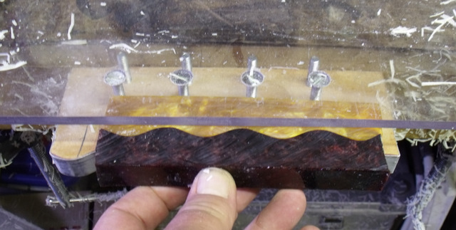

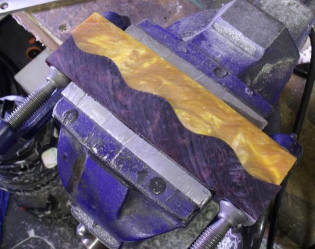

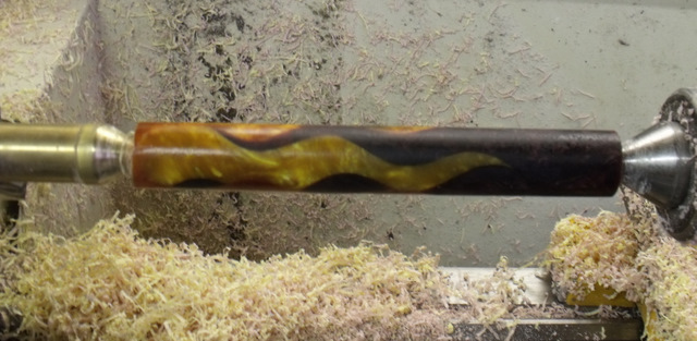

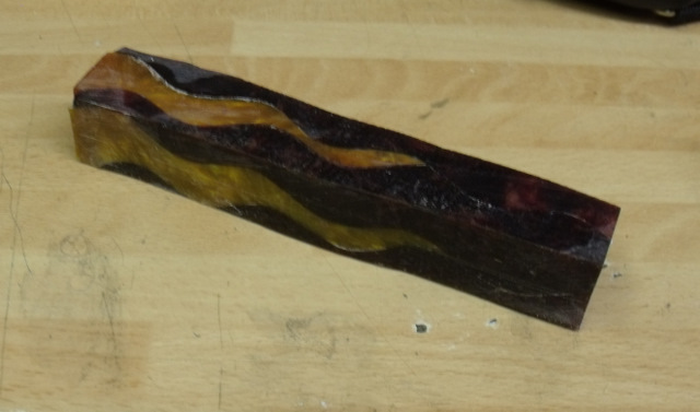

You can see how I did it by the sequence of pics, but I did one cut ( no pic ) in the wrong direction and it sort of messed up the opriginal idea.

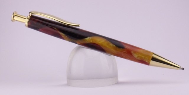

However, I think the final resulting pen actually has a pretty good 'fire' look to it. I'm as mad as hell for not concentrating but I finished it so as not to totally waste the time and blanks.
I'll post a pic of the pen when I finish it later in SOYP. There is routered PR waste on EVERY surface including the ceiling in my shop. If you router PR, you'll know that it gets statically charged and sticks to everything!!!:rolleyes::biggrin:
EDIT; Ok, I finished the pen but I don't think it was really worth all the effort after all. It's 'OK' but not anything special so I'll just stick the pic in here:wink:
