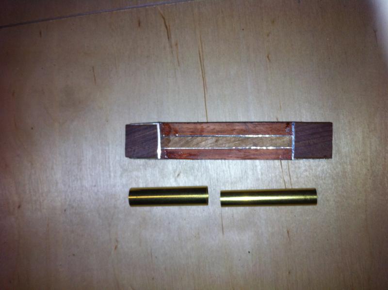

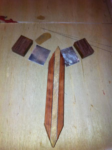

The pen light is simply slicing a blank in half gluing in a different type wood and making a sandwich. After the glue dries you flip the blank on its side and do the same thing. For the scallops There are several places to get info, the best place being the library. I show 2 crude pics of the cuts for scallops and what the rough finished blank looks like after they are all applied. when you start turning the blank round, those small blocks that are glue onto the angles will start to become rounded. The kit for the pen light is from PSI. Runs on 2 AAA batteries.
