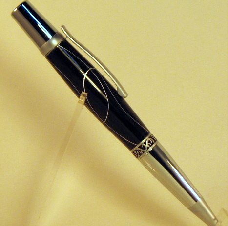

Tried another Segment with Aluminum and Danish Bog Oak from Neil (wolftat) I used a two-tone Chrome Elagant Beauty Sierra kit . I think I got a little better with my scrollsaw this time . :redface: Comments appreciated . Thanks for looking !

Chuck, great looking pen, what kind of glue/clamps did you use ???
Dave
Thanks Dave ! I used medium CA because I don't have thick (yet) . Makes it kind of messy but fun trying not to get fingers stuck to things . :biggrin: I used a small C-clamp , adding to the fun . I should be using a vice lined with wax paper , and I have one now . Will get some wax paper and do the next one the right way .
Much neater, and the intersecting lines are much closer! Can I ask what size blade you use? As I'm amazed how thin compare to some of Hegner blades!

Phil , I am using Delta blades # 40-670 , the width is .045 thickness .018 and 12/8 TPI . Thank you for your compliment .

Chuck, that looks great. I saw the first one you did and the joints were off just a smidgen. Looks like you nailed it second time around. Well done!
Thanks Keith , I did get them a little closer this time . Next time I'll use a vice and thick CA . Should be even closer . Thanks for the inspiration too.
