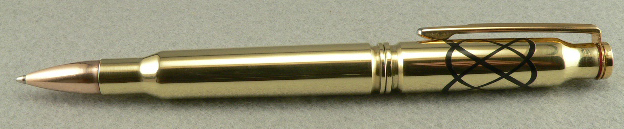

Still working on getting all the points to meet. I think the black against the brass looks good. The next one will be a six segment knot with alternating red, white and blue.
I made this one with a five segment knot so each end of the knot has a differnet pattern

I like the knot on the top barrel a lot better.
I would consider shortening the neck on the upper barrel. It'll bring the clip closer to the center and reduce the mirror look, which I've always found odd.
Very cool work, looking forward to the next one!
Why did you chose a 5 sided knot??? Won't an even number be more balanced??? Do not get me wrong this looks great. But there is something of a different look than what we are used to I guess.
Just to do it. I have made knots with 3,4,5,6,8,10 segments. The higher numbers are too busy for my taste, but I have sold a number of them. It is not what I like but what will sell.

I guess we all have the right to an opinion. I personally think that this pen is one of the better cartridge pens that I have seen. The celtic knot really makes this one stand out in the crowd. Outstanding work.
looks like a sticker on brass to me ?
I think you need glasses, of course as Neil said we all are entitled to our opinions no matter how ludicrous they may be. I've made and sold 30 or 40 cartridge pens, most with Antler tops sections, but that is far and away the sharpest I've seen. As I've grown older I've come to realize that as with certain bodily orifices we all have opinions.
very. very, nice work!! I think the knotwork sets it apart, without it the pen may be boring. But i have to agree on shortening the upper barrel just a little bit. Great Job!!!
