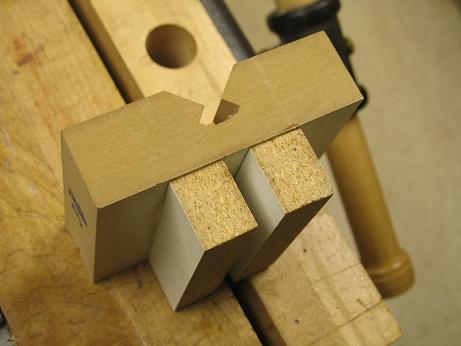

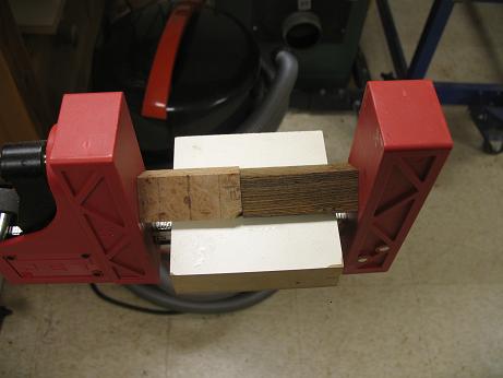

Here's what I use...
I made this to work with my parrallel clamp. It works for non-angled segmenting only. first pic is end view. The 45 deg slot holds the blank segments. The two runners are spaced just far enough apart to fit over the bar of my parrallel clamp. The second pic shows the jig in use. It's not shown here, but i always line the jig with wax paper so glue does not stick to it. While slowly tightening the clamp, I press down on the segments to make sure they are all touching the bottom of the jig. This makes sure the segments are aligned on the two sides of the segments tht sit in the slot. It helps if you start with segments that are squared the same size, but even if ou don't you'll just need to trim the two sides that don't align after the glue has dried.
