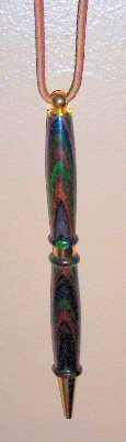

I had someone ask about a full sized pen that would hang from a neck chain and this is what I came up with , he absloutely loved it .
The top is the top part of a key ring kit and it fits perfectly in a 7mm tube .

Doug's idea is very sound.
If you omit the clip, you can turn the end of the top barrel to a regular 7mm bushing, and then the finial from the key ring kit will fit perfectly.

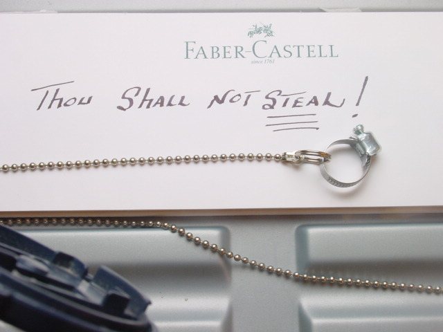

How about this.......I use the same thing, only without the secure tightening loop. I am not affraid of theft at the several doctors offices I have them, just a friendly reminder it is not theirs.

Anthony, where did you get the chain with the large loop on it? I am not talking about the hose clamp, but the one it is hooked to.

That one came like that. The ones I made. I used CA and glue the one end into the stand, and soldered the loop on. I found all the stuff at the local hardware store.

Do what I did , take a key ring apart !!! [:D][:D]
The top finial actually comes off very easy . Just put a small rod through the hole and twist and pull .
