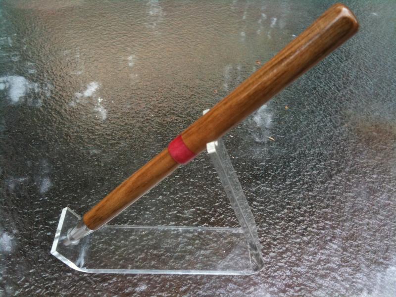

I'M SO HAPPY WITH THIS ONE!!! After I got as close as I did on my first one, I HAD to try to make one for my own personal use. I had WAYYY better luck gluing the label down, and I adjusted how I apply the layers of medium CA to get it built up right. It allowed me to properly polish it and get the look I was dying for. It's black walnut, CA finish, and I can't begin to guess how many coats of medium CA I did.
Looks pretty good to me. Now close the finial end :-)
I know, I know. I need to get that one figured out with supplies on hand currently or wait until I get new toys. I was tempted to try to close it and figure out how to polish it, but the finish was so clean and the results were so perfect I was too scared to experiment.
I'm not too sure about a cigar body on a slim. It seems way too out of proportion to me. I totally get the concept but not sure if that is the best kit to use for it. Just my humble opinion. On the positive side, the finish looks great. The label seems to have been wrapped very well. DJ
I hear ya. Right now all I do is Slims because they are within my budget, and I like to run downstairs and crank one out as soon as I have a hint of an idea. I plan on getting one of these done on a full size closed end kit one day, but not right now. What I have gathered so far is that in the hand, these do look and feel an awful lot like cigars. Even have the right weight to them.
I really like that one looks good. If you have a chuck for your lathe couldn't you take a longer blank then what you need for the pen. Drill one end of the blank and then use a 60 degree on the tail stock end and turn your blank to size then part final end off and you should have close end at the top. Don't know if that would work. Just a thought.
A couple of things occurred to me while trying to figure out a closed end on my equipment. If I wanna do a 1 piece Slim for one of these, there's not really a way to glue the top tube in for it. The finishing would also be tough. I will have to spend some time figuring out how to iron out all the kinks.
