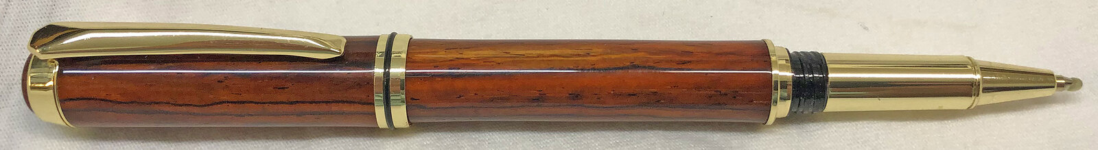

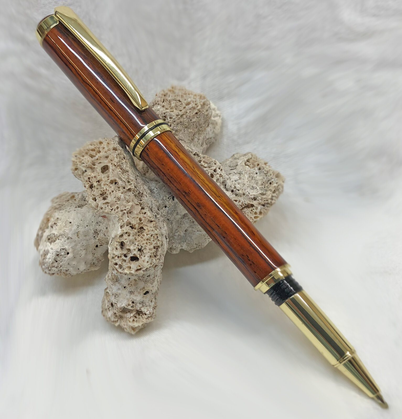

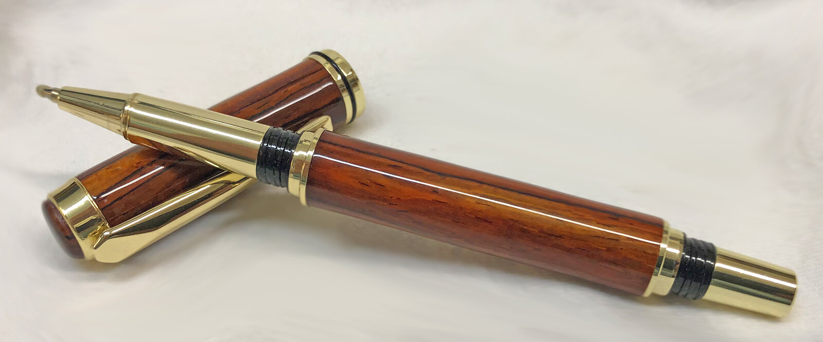

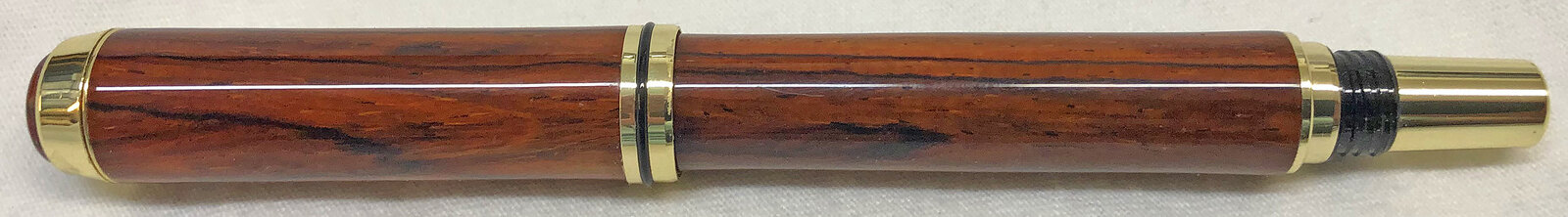

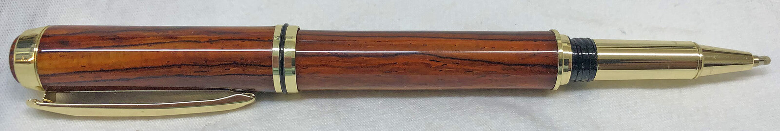

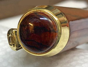

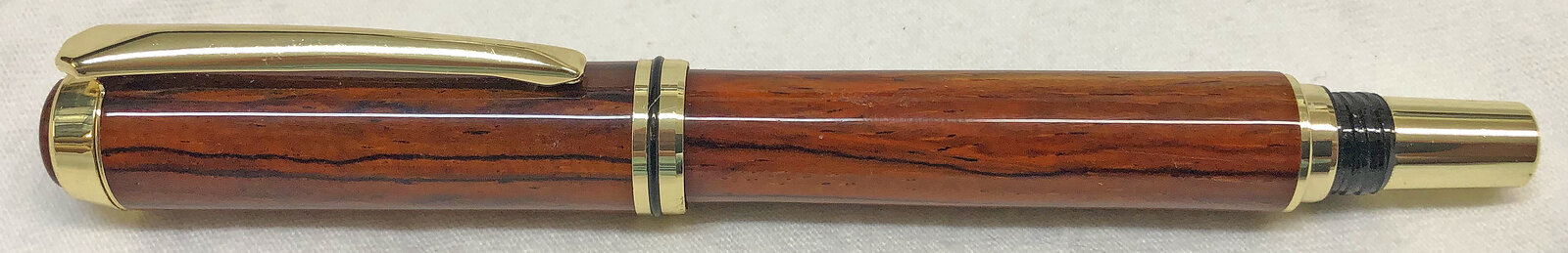

Well, as I should have expected, my second custom finial pen was a learning experience. I made a Gold Jr Gent using Cocobolo. I had a blowout on my first Cocobolo blank when I was drilling the cap - just not enough blank for the size of hole I was putting in it. The second blank came out much better - I don't know if it made the difference or not, but I wound up using a drill bit designed for plastic instead of my standard twist drill. The pointier end is less grabby especially when piercing through the bottom of the hole.
My learning take away from this one is that I need to undersize my custom finials more when I turn them. This one had a very tight fit and I think some of the CA must have scraped off around the edge when I pressed it in. Having to press it in was another clue that it would have been better undersized a little more. Still, I think it made a pretty good pen. Here are the pictures. - Dave
Glamor Shots.

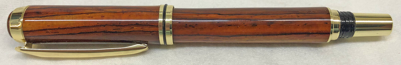

Standard Pictures as it is rotated (with Cap on).

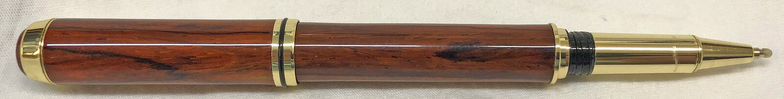

Standard Pictures as it is rotated (with Cap posted).

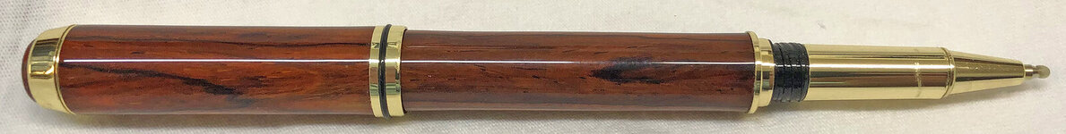

Here is a shot of the Finial by itself.
