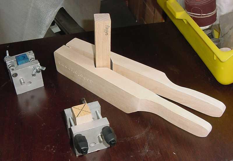

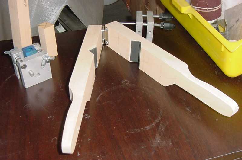

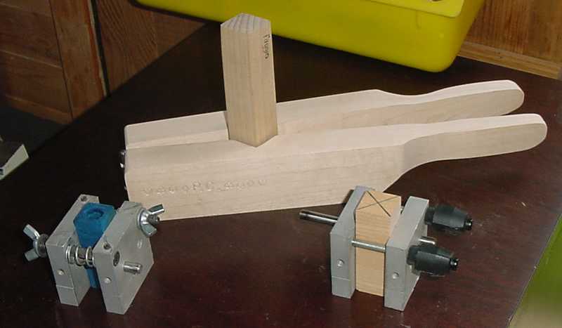

Okay, these are mine PEN BLANK VICES. While they're not quite on the Paul Hoffman scale they're pretty accurate and are all made from scrap lumber(maple) or odds 'n ends that I've scrounged in the maintenance shop. They are particularly useful to new penturners just starting out or anyone that is on a tight budget.
-Peter-

Peter, tell me honestly, did you mess up the cuts on the clamp style? I noticed the insert at the jaws and it looks just like mine, that I cut on the wrong side of the line I marked when I cut the hold for the blank.

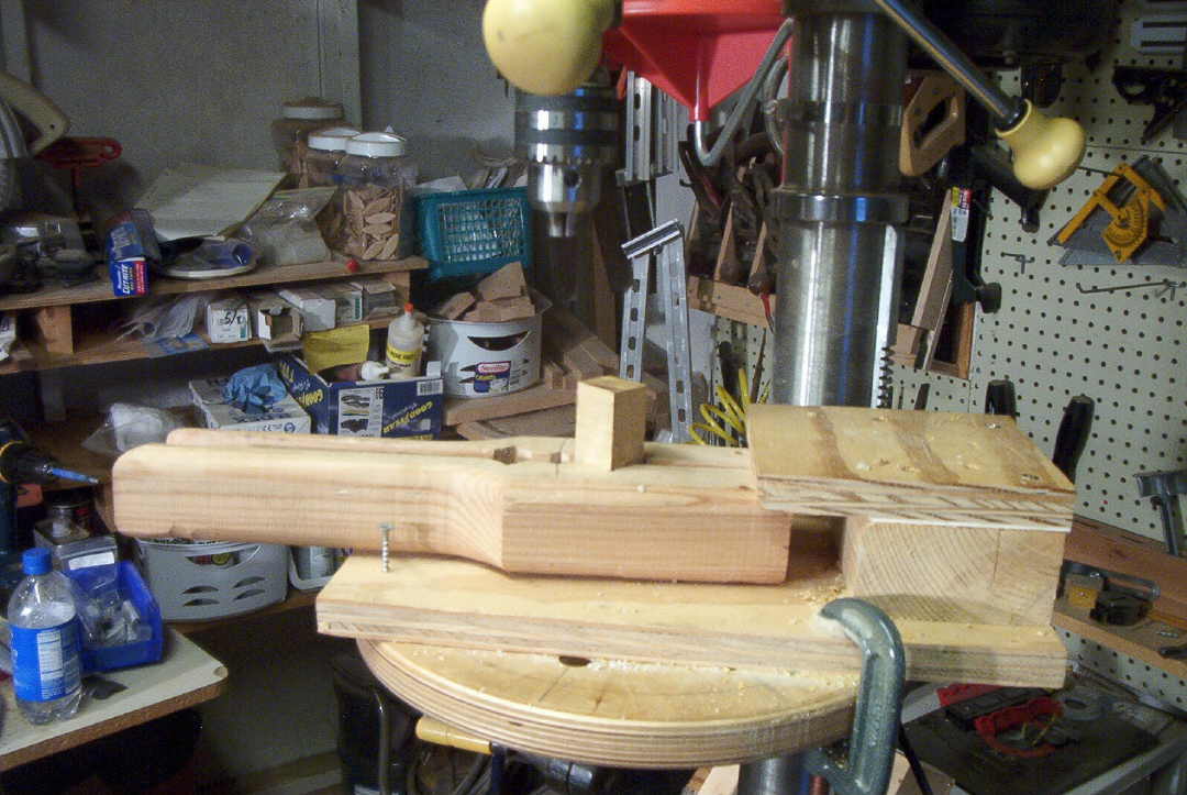

By the way, here is mine. The t-track & knobs make it so fast and easy to micro adjust. Plus I can loosen the knobs and it slides off in seconds to put my fence back on.

Hi Lee,
no, I did not mess up at the insert jaw sides. The black thing is an automotive foam tape that allows better gripping of the wood blanks when clamped in the jaws. I really like your T-tack and knob design, I may need to borrow your design inspiration with my version II clamp. Thanks for sharing.

Looks like everyone keeps improving on the last one. Now that I have seen Lee's I have one or two things I would like to change on it for my own design, and then I'll post a picture. I have one of the ones from CSUSA, which isn't bad, but it is slow to use and has a lot of play in it.

Lee,
I think yours is great, one of the best I have seen, but I think I would make three changes I think when I make one to replace my current one-
* Make a wider base on the back piece that is attached to the table, just to be sure it is totally vertical and more stable (although I admit it is overkill probably).
* You have plenty of adjustment forwards and backwards but I can't see any side to side adjustment. My table will shift slight as it goes up and down so I think I would make the hold-down holes as short slots so I can adjust side-to-side and front-to-back.
* I would also add some sort relief area around the bottom of the hole for sawdust chips that accidently get in there.
Out of operational curiousity- does it do OK with various sizes of blanks? Sometimes when I make slimlines my blanks are only 5/8" but other times they are up to 1" square. Also, after you drill one does the sawdust generated cause any problems? Do you vacumn or just brush it away?

I too would much rather have a wider clamp bars and might make another wider one laer on, but honestly, this one is dead on and stays that way. For the most part side to side is not needed as the blank is centered, however any movement (on mine at least) is easily taken up by moving the table side to side. Much better than making the clamp move too. I get it lined up with one hand knob loose and the table about 75% tight. I can move the clamp forwards and backwards (keep in mind, I can skew it quite a bit as the bolt shaft is a little smaller than the t-track slot)if I need to adjust it sideways I can knock it side to side by tapping the table. It works nice. (kinda like that end drilling jig I posted a photo of.. Now that is a lot of sideways movement!! [:D] I would highly recoment to not make the clamp slotted. It's not needed and might make it harder to fine tune.
Now the wood chips is a pain. If I make a new clamp I may get it all done and flip it over and drill a forstner bit hole about 1/8" deep at to bottom. I just blow it off a bit on the second blank and I slip the clamp off the table when not in use. Minor pain so it's not too bad. Now I made mine for 3/4" blanks. It's great for that and I hvaae done 1" blanks with no problems. Yes the clamp does not shut all the way like that, but no problems at all. You could make it with 3 cutouts and adjust the table left or right to do above & below 3/4" I have access to lot's of Paduck and there is a bunck of 2" x 1" stock. I might make a new clamp in Paduck. If I do this I will also add the 1" hole as I get a lot of 1" stock to mill into blanks.

Thanks for the response, and I agree with the side-to-side logic after reading your reply and thinking about it. I think the idea of drilling a relief with a forstner bit makes sense, just to eliminate the last little chip that doesn't get brushed out and then makes problems. Nice job, think I will try to get mine made in the next week or so. [8D]

One more tip. Everynow and then I have a blank that is slightly undersize. (I buy scrap exotic's and mill my own) Every now and then I get one that is a hair under due to planing, ect. My next one will be just 1mm or 2mm under the 3/4" blank so I can clamp one slightly undersized.
