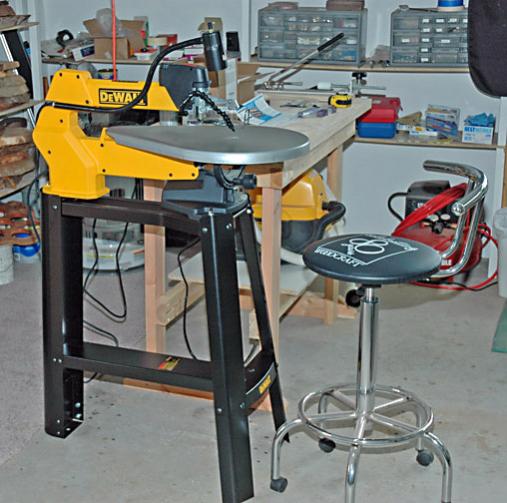

I just bought a Dewalt DW788 and love it. I would call it the high end of the less expensive saws. Great reviews on it if you google it. Hope this helps.
I second the DW788.
