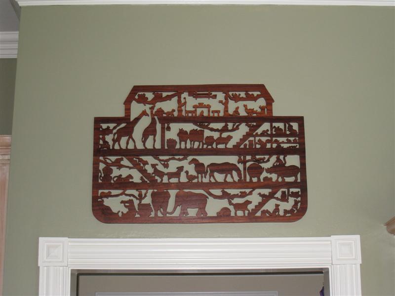

My scroll saw is an Excalibur with a 30 inch throat. This is something I did a few years back. Below it is a door way to show the scale of it.
But I have made several of them at once by stacking them up to 3/4 inch thick. If not cut correctly the bottom cuts will be crocked and not look right.
