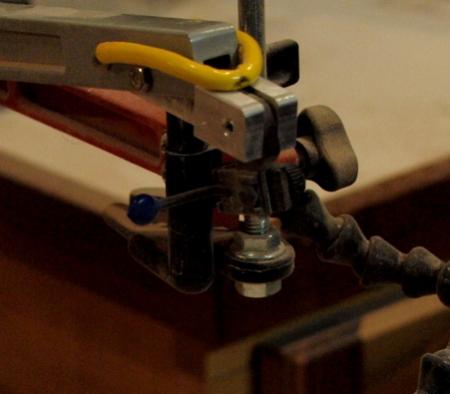

Doesn't the DW20 already come with a quick blade holder as a standard option? All the ones I see in the stores already have them, and if that is the case, then that would be why Frank doesn't make them for those saws. I don't own a Dewalt and don't study all the saws on the market, so I am not completely familiar with them all and what features they provide.
My Dewalt has the thumb screws and I just checked the Dewalt site and they have the thumb screws on the new ones. I was also wondering why Frank didn't have anything for the Dewalt because this is my only complaint about the Dewalt saw and it is one of the more popular saws. I have never seen a quick blade holder for the Dewalt. Do you have a picture or link Jeff as I would be interested in seeing it in hopes of maybe duplicating something like it.
sure, here's a pic. I have this on the top and the bottom. It's like a set of brake shoe's and you just pull that lever on the left towards the front and it closes the shoes and locks in place, then you just push the lever back to open the holder again. There is a tiny adjustment knob on the side of it to adjust it for larger or smaller blade sizes..so you have to adjust it according to how thick you blade is, but once that is done you only have to pull back the lever every time until you change for a different size of blade. The yellow lever up top is completely different from the holder..that is a quick tensioner.
is your 20" saw a DW788?
