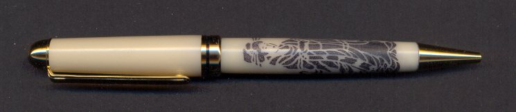

This is the renshape pen I posted some time back. It looked close enough to ivory for me, so I put on some scrimshaw. Now for the fine print, (cause I can't tell a lie);), I finally got the software bugs out of my laser engraver with the rotary attachment. snicker, snicker I'm so tickled with this I almost ......., well that's enough details about that! Just couldn't be happier. After some confidence is built, I may be selling time doing this for others. Used some cheap electronic clip art from Dover Publications. This will probably go to my daughter after some gloat time. She loves all oriental.

The burn from the laser is just barely deep enough to catch a finger nail. It is really more like an etching. I didn't know how this stuff would etch, so it was a guess on the laser settings. The black is just rubbed in with a black Sharpie and block sanded off on the lathe with 400 grit. I got in a hurry, but next time I will use india ink for a darker color.

This is a great looking pen, Rich. Where did you get a laser engraver? I am fairly ignorant about them. I have had several people ask me about engraving. Also how is the engraving process done? Post some picture if you can. Kirk [8D]

The laser engraver is very basically like a dot matrix printer, but instead of ink you have a laser beam. The beam comes from the back of the machine, hits 2 45 degree mirrors, then down through a focusing lense. The lense travels back and forth and the laser beam comes out at the appropriate times to vaporize the material. I also have a rotary attachment that holds the pen and rotates it in unison with the lense movement. It's an incredible machine that with the 2" lense will cut a .005" line. I didn't time the burn on the pen, but it must have been less than 3 minutes. My favorite part of all this is easy art work. It works off the printer port on the computer and will print anything that is on the screen. You don't need "lines" like a computer numerical controlled router, all it needs is a picture. It will see shades of gray and different colors to change intensity of the laser beam to change the depth of cut. You can almost get a 3d look. The bad news, MONEY! My machine is 25 watt laser (small "horsepower", lasers here at Caterpillar are up to 3,500 watts to cut thick steel) and it was a rebuilt 7 year old machine. $9,000 with the rotary attachment. I bought it from ACCESS Lasers in Hudson WI. Very nice people. I had a portable bandsaw mill and sold it when I had too much lumber. As I explained it to SWMBO, I have to reinvest that in machinery so we don't pay so much Federal Income Tax. I think it worked?
