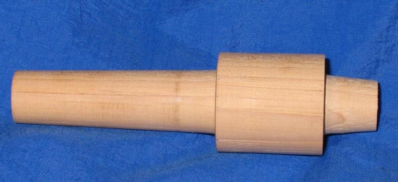

I made this from a scrap of Hickory. It has MT2 on one end and a taper to match the inside of the thimble on the other.
I drill the thimble, then press it onto this chuck like a jamb chuck and finish the turning.
