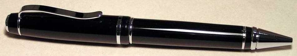

I'll have to look into the "Mothers". I just finished a black acrylic cigar pen for a special order and I found buffing it with white diamond did the trick:
I am really starting to enjoy turning the acrylics!

I use an inexpensive 4" buffing wheel from Harbor Frieght. It has a 1/4" mandrel attached, so when I am done turning the pen, I just swap out the pen mandrel for the buffing wheel and I'm set to go. I have the more expensive Beall wheels attached to my shopsmith, but I have had problems using with them acrylics. I've never used a Chomois wheel. However, the key is once you use a wheel with a compound, like I do with white diamond, do not use any other compound on the wheel. Doing so contaminates the wheel and can cause problems, not that I would know anything about that. [:(!]
Good luck!
