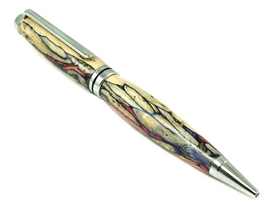

OK, I was watching "How It's Made" on the Science Channel tonight. They had a segment called Heather Gems. Its a plant that was once used to thatch roofs. They harvest it, tumble it in a drum with media to remove the greenery and bark. Then they bundle it in small bunches put it under vacuum to remove any moisture then force colored dye into it under pressure. They then take the different colors of dyed heather and mix it up, place it back in a bundle and dip it in a resin. They place several bundles in a press and form a "brick". Its then baked in an oven to cure then sliced on a band saw and made into jewelry.
They sand it and seal it with several coats of lacquer. It sort of resembles Dymond wood and Colorwood only its made of this heather. At the end they showed different items made from it including a magnifying glass and a pen. Has any one seen this heather for sale as blanks to turn into pens or other items?
Here are some pictures of the process....

I see on their website that the only pen they're selling is made with what appears to be a designer pen kit, personally I would've gone with a higher end pen kit. I only wish I was the lucky guy who gets to turn their pens for them. I think I would get a real kick out of it.
