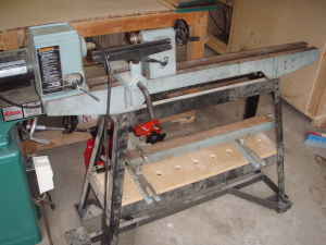

Sure LOOKS like my lathe!!!!

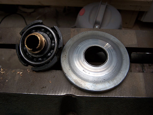

It uses the split pulley to change the speed (It's a 46-700 12" variable speed), and the outboard side pulley is sheared off. So when I did my quick check at the guy's house, it ran fine. I didn't try to adjust speeds or anything because I wanted to look for a manual or something before I started screwing with it. Once I screwed with it I discovered it didn't matter what speed I set on the lever... The belt was riding on the shaft! LOL!
Anyway, $50 part from ServiceNet, but I just posted a wanted over on OWWM to see if I can get it cheaper first. heh
Here's the part that's sheared off. You can see the center of that pulley beneath the brass insert on the bearing side.

Yeah, I've got all the books. (OWWM For The Win!) Dewaltservicenet has the pulley part I need for $50. I was hoping someone had one used for cheaper, but no responses over there as yet. If nothing by tomorrow I'll go ahead and order it from DWSN.

I'm ok with paying the $50 ($65 after shipping and tax. Ack!) I'm still ahead of the game with this lathe.
